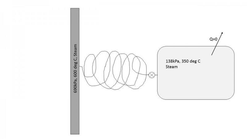

Say I have a line of steam with temperature 800 deg C, at 10bars connected with it is a partially evacuated tank 0.01 bar pressure, room temperature. The connection was built with a long capillary and a valve. Does throttling effect experience when the valve suddenly opened? Why and why not?

Say, I've got only one tank (adiabatically-insulated so that no heat crosses the inside to the outside) with 6 kg steam at 138kPa, 2000C. This is connected via long capillary and a valve to hold the cross main pipe of superheated steam having a pressure of 680kPa, 3500C to enter the tanks.

I don't understand your description. Can you please provide a diagram? Thanks.

Is it safe to assume that the capillary is insulated?
Yes, Chet.
OK. We are going to assume that, at any given time, there is negligible mass holdup in the capillary (compared to the tank). Our open system is going to be the combination of the tank and capillary. I assume you are currently studying the open system version of the first law of thermodynamics, correct? Are you allowed to use the steam tables to solve this problem?

Let ##m_0## represent the initial mass of steam in the tank
Let ##v_0## represent the initial specific volume of steam in the tank
Let ##u_0## represent the initial internal energy per unit mass of steam in the tank
Let ##\Delta m## represent the mass of steam added from the pipe to the tank (through the capillary)
Let ##u_f## represent the final internal energy per unit mass of steam in the tank (after ##\Delta m## has been added)
let ##v_f## represent the final specific volume of the steam in the tank (after ##\Delta m## has been added)
Let ##h_p## represent the enthalpy per unit mass of the steam in the pipe
Using the open system version of the first law, derive an equation for ##u_f## in terms of ##\Delta m##, ##h_p##, ##u_0##, and ##m_0##. Derive an equation for ##v_f## in terms of ##m_0##, ##v_0##, and ##\Delta m##.
For ##\Delta m=0.5 kg##, what are the values of ##u_f## and ##v_f##?

First Law Open System Energy Balance on Tank:$$\Delta U=(\Delta m) h_p$$or equivalently:$$(m_0+\Delta m)u_f-m_0u_0=(\Delta m) h_p$$Final Specific Volume:
$$v_f=\frac{m_0v_0}{(m_0+\Delta m)}$$
The equation I gave in my previous post was the integrated relationship (integrated with respect to time). It just struck me that you might have been interested in the differential version of the relationship:
$$\frac{dU}{dt}=\frac{(mu)}{dt}=\dot{m}h_p$$
And, yes, since we are assuming there is no mass holdup in the capillary, the enthalpy of the steam entering the tank from the capillary is the same as the enthalpy of the steam in the pipe. This assumption permits us to regard the capillary as operating at an instantaneous steady state.
