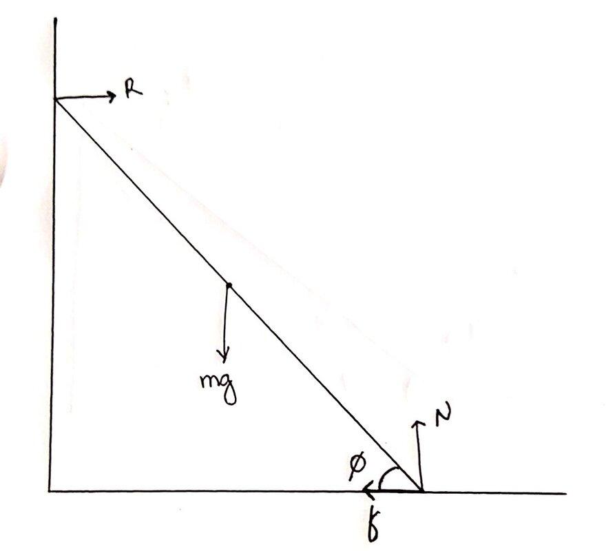

A uniform rod of mass M and length is placed against a smooth wall. the coefficient of kinetic friction between the floor and the ladder is cot(phi)/4
where phi the initial angle of inclination of the ladder. Find the time taken by the ladder to slip and become horizontal.
T = I##\alpha##
F = ma
Free-body diagram of a ladder leaning against a vertical wall with its foot on the floor, showing forces R at the top, mg at the midpoint, N and f at the base, and the angle phi at the floor.
$$ R - f = m\ddot x$$ $$N - mg = m\ddot y$$
were N and R are the normal reactions from the smooth wall and rough ground.
and f is the friction provided by the ground.
$$ f = \mu N = cot(\phi)N/4$$
i tried to formulate a constraint relation between ##\ddot x## and ##\ddot y## so that I could solve the above equations
since $$x^2 + y^2 = L^2$$
$$ x \frac {dx} {dt} = y \frac {dy} {dt}$$
$$ \frac {dx}{dt} = tan(\theta) \frac {dy} {dt}$$
$$ \ddot x = \ddot y tan(\theta) + \dot y \dot \theta sec^2(\theta)$$
the problem here is the ##\dot y##!
also ##\theta## is the angle made by the ladder at some time during its motion(##\theta## changes with time)
Taking the torques about the center of mass of the rod gives me
$$ (Ncos(\theta) - fsin(\theta) - Rsin(\theta))L/2 = I \frac {d(\omega)} {dt}$$
$$ \frac{L}{2I}\int_0^t t\,dt = \int_\phi^0 \frac {d\theta} {(Ncos(\theta) - fsin(\theta) - Rsin(\theta)}$$
here I end up with an integral that I am unable to solve!:oldcry:
can someone tell me if I am doing something conceptually wrong here or if I have made some major errors in my process?
also would there be an easier way to solve this question as my teacher called it "trivial" and I can't seem to get my head around it.
thanks:)
What exactly do ##x## and ##y## represent in your equations? It looks like they are the distances of the two ends of the ladder from the corner. If that's the case, you cannot write the Newton's second law equations as you have. Consider instead the motion of the center of mass. Can you imagine what kind of path it describes as the ladder slides?
yes, they are the distances of the ends of the ladder from the corner.
ok I think I understand the mistake I have made here if let's say ##x## and ##y## are the coordinates of the center of mass then there would be only a slight change in the equations
$$x^2 + y^2 = (L/2)^2$$
but again this will become
$$ x\frac {dx}{dt} = y\frac{dy}{dt}$$
and hence the other equations will remain the same.
also the torque equations?
This equation$$x\frac {dx}{dt} = y\frac{dy}{dt}$$ isn't much help. You have three equations and three unknowns, ##N##,##R## and ##\theta##. You need to use the two force equations to eliminate ##R## and ##N## from the torque equation to get the equation of motion involving ##\theta## only and see what it looks like. It's probably something horrible that cannot be solved analytically.
Your other option would be to use the work energy theorem to get an expression for ##\frac{d\theta}{dt}## and see if you can integrate that. Finally, I am not sure that the rod maintains contact with the wall at all times. You may need to investigate that.

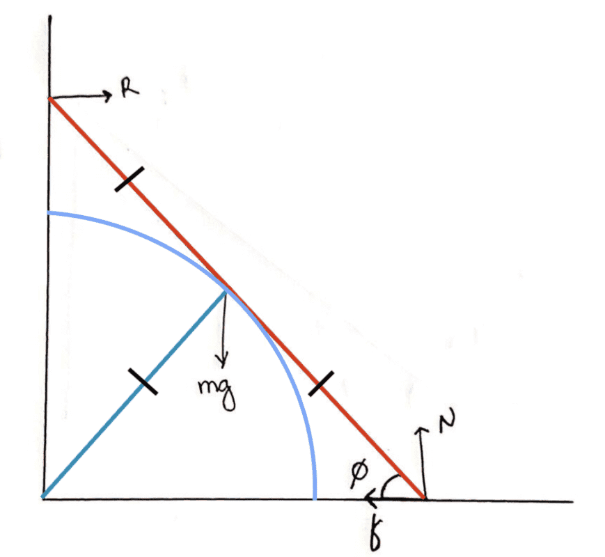

Construct an imaginary line segment between the corner and the centre of mass of the rod. As the ladder falls, assuming it always remains in contact with the two walls, the geometry of the problem looks like this:
Diagram of a ladder leaning against a vertical wall, with its top end sliding down the wall and its bottom end on the floor, showing forces R, mg and N, friction f and angle phi, and a blue quarter-circle traced by the centre of mass.
Notice that there are two isosceles triangles present in the figure; consequently, the line segment from the corner to the centre of mass is of constant length ##L/2##. You deduce that the centre of mass traces out a circular trajectory of radius ##L/2##.

You will find a derivation of the relevant equations here. It is a bit more general in that there is friction at the wall contact (same ##\mu##) as well. It is not a trivial problem. At least I would love to see the teacher's solution.
That's what makes this problem interesting, it can't.
I am not able to see why it would lose contact with the wall? there is no force towards the right other than ##R##(normal reaction from wall) also the rod is of negligible thickness.
so why exactly should it loose contact?
If it were to maintain contact all the way, when it reaches the horizontal it would have zero horizontal velocity. How can that happen?
