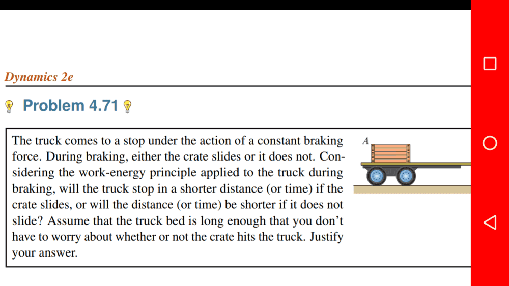

Andrew1234
The problem is attached.
1/2mv^2 = (Fb+Fk)d
The truck stops in a shorter distance if the crate slides but why is this the case considering that friction on the crate does positive work on the truck, since it points left for the crate but right for the truck thereby opposing the braking force?
I understand why using the equation
1/2mv^2 = (Fb+Fk)d, where Fb is the braking force and Fk the spring force, d is shorter if sliding occurs but not why Fk is directed opposite the motion given that it points opposite the crate's velocity, left, but must be balanced on the truck's free body diagram by an equivalent force that points to the right.

Do you think the centre of mass of the truck-crate system might be relevant?
Just to be clear, is this your question: Why is the force of friction that acts on the truck (from the crate) in the direction of motion of the truck?

My question is why the equation used to solve the problem that leads to the correct answer suggests that the force of friction that acts on the truck (from the crate) opposite the direction of motion of the truck, although if the internal friction of forces are balanced I think the force of friction that acts on the truck (from the crate) is in the direction of motion of the truck.

The center of mass should be displaced by the same distance since the external horizontal forces are equal.
Try looking at the problem the other way 'round. Is the sliding more likely or less likely under the conditions of the braking force causing:
  1. truck stops abruptly
  2. truck stops slowly
The equation 1/2mv^2 = (Fb+Fk)d is, in fact, misleading if you interpret as saying that Fb and Fk act in the same direction.
It would be better to write the work-energy principle for the truck as ##\Delta K_{\rm truck}= (\vec F_b+\vec f) \cdot \vec d## where ##K## is kinetic energy and ##\vec f## is the kinetic or static friction force that the crate exerts on the truck.
It is for you to decide if the two force vectors ##\vec F_b## and ##\vec f## are in the same direction or opposite direction. Also, decide if ##\Delta K_{\rm truck}## is positive or negative.

You are right that the friction force on the truck (from the crate) is in the opposite direction of the braking force on the truck.
Kinetic energy is positive
Yes, but it's the change in kinetic energy that is important in the work-energy theorem: ##\Delta K = W_{\rm net}##.
Is the change in kinetic energy of the truck positive or negative?
so if the friction opposes the braking force d must be larger if the crate slides.
How do you come to this conclusion?
The problem requires you to use the work-energy theorem applied to the truck. Personally, I don't find using this theorem to be the best way to arrive at the answer. It seems to me that the answer is much easier to obtain if you just use concepts of force and acceleration. (Also, see post #6 by @phinds to get an intuitive feel for the answer.) But I might be overlooking something.
Anyway, can you tell us your line of reasoning for concluding that "d must be larger if the crate slides"?

The thing missing from your equations and your reasoning is mass. Force alone does not determine deceleration or stopping distance. The mass of the object being decelerated is also important.
Alternatively, when the crate does not slide, does the crate not exert a force of the truck in that case too?

The question wants you to use the work-energy theorem as applied to the truck: ##W_{\rm truck}^{\rm net} = \Delta K_{\rm truck}##.
Let ##F_B## and ##f## be the magnitudes of the braking force and the friction force acting on the truck. So, ##F_B## and ##f## are defined here to be positive numbers. The horizontal forces acting on the truck are shown below as the truck moves to the right a distance ##d## and comes to rest.
Let ##K_0## be the initial kinetic energy of the truck.
@Andrew1234 : Write out the work-energy theorem in terms of ##F_B##, ##f##, ##d##, and ##K_0##. Be careful with signs. Solve for the distance ##d##.

I'm not sure any of that is valid. The problem I see is that it doesn't adequately reflect the physical scenario.
You have to think first what happens physically if the crate slides. There are two phases of the motion:
1) The truck is decelerating faster than the crate. The external force on the system is ##F_b##, the maximum braking force.
2) After the truck stops, the crate continues to slide until it comes to rest. The external force on the system is no longer the maximum braking force. The driver must keep the brakes applied, but the maximum braking force is not required simply to stop the truck being dragged forward by the sliding crate.
Any analysis must respect these two separate phases of motion.
