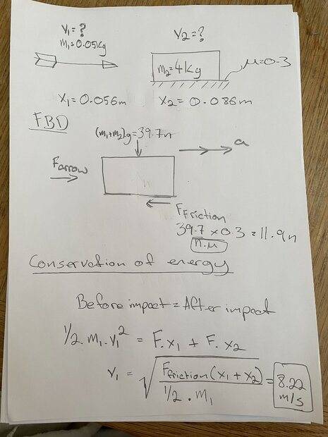

I tried to solve by using the conservation of energy where I had the kinetic energy of the arrow before impact equal the work required to penetrate the arrow (F . x1) & move the block (F . x2).
Then I tried to arrange the expression and solve the velocity of the arrow although I did not get the correct answer.

Why do you think energy is conserved?
I assumed that the kinetic energy from the arrow would be used to penetrate the block and move the block.

Perhaps you should give up on that site. This is what's called a totally inelastic collision, where kinetic energy is not conserved. Momentum, on the other hand, is conserved.
Okay, thank you for the insight.
I'm not sure as to how to use momentum to solve the problem when the velocity of the arrow or the target is not given in the question tbh.

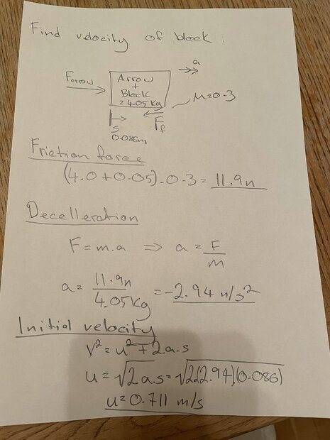

I've tried to use Newton's second law to determine the deceleration generated by the resisting friction force.
Then using kinematic equations to solve for the initial velocity - 0.711m/s2.
Would you have another in mind?

That looks like a good start. Now, can you use conservation of momentum to get the velocity of the arrow before the collision?
See below. Your answer is correct and the book is wrong.

I have used momentum to determine the velocity of the arrow to be 57.6m/s.
Thank you for the help.
