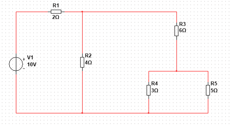

Hi Guys,
Trying to answer the following question with the attached figure
Q) To simplify the process, determine & draw the Thevenin equivalent circuit and then calculate the current through the R5 (5Ω) load resistor.
I have followed a similar example on this forum and got a final answer of 0.908A - can any else confirm this ?
Using an online calculator to get most of the way there and then just applying a final equation of Rth = VOC/ISC i get 0.45A
Any and all help would be great - Thank you all in advance
Welcome to PF.
Can you show us your work that resulted in that answer?
