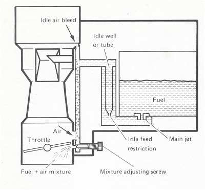

In carburetors, at the throat or ventury, the area decreases and so velocity of air increases (by continuity equation.).This is reason for suction of fuel from the float chamber.But in case of throttle valve, when the valve closes(area of flow reduced), the quantity of air fuel mixture passing reduces instead of velocity increase(with same flow rate) why?.Why can't we apply continuity equation(A1 V1=A2 V2) at the throttle valve?
A compressible fluid will not follow that equation since more can be squeezed into a smaller area.
old style carbs had two circuits. low speed idle and high speed to take advantage of the venturi effect.

Ok.For compressible fluids, A1V1=A2V2 will not hold.But in carburetors, till the throat they apply the continuity equation for incompressible fluids(air is the fluid). The throttle valve will be below the throat. At the throttle valve(air fuel mixture), in most of the books they would not apply A1V1=A2V2.Does air becomes compressible because of fuel addition?
Air is always compressible. In some circumstances, the equations for incompressible fluids may give a good enough approximation.
At the throttle valve(air fuel mixtureis the fluid), in most of the books they would not apply A1V1=A2V2.Does air becomes compressible because of fuel addition?
The addition of fuel, with evaporation and cooling, may have an effect. I am not familiar enough with this subject to say more.
