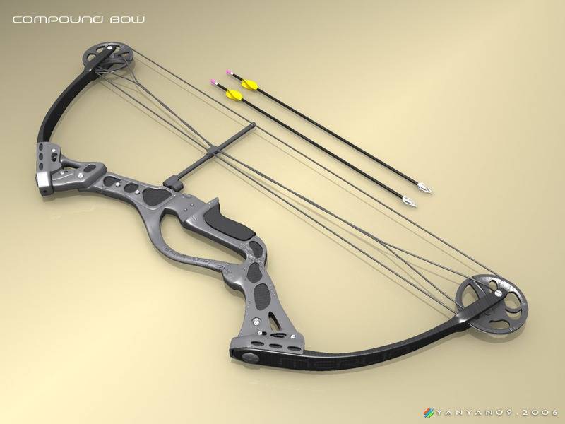

Compound Bow:
http://img02.deviantart.net/66f6/i/2006/290/4/3/arrows_and_compound_bow_by_fafcf09.jpg
A catapult like device?
fireflies said:
Can it sustain 1 kg? Force should be given more then manually, right?
Scale it up to the largest you can within your groups rules. Read about what the compound feature gives in terms of benefits to the archer... :smile:
Also, you might want to use some sort of ratcheting mechanism to pull down the cable, more like you see with a large crossbow...
On second thought, if you do use mechanical advantage and a latching/ratcheting mechanism, that gets rid of the need for the compound mechanism. The compound bow's claim to fame is the "let-off" as the cable is drawn farther back.
