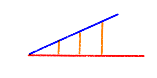

Another way to see what's going on is to imagine each shuttle reeling out a cable as it travels. Each cable will be perpendicular to the line of motion of the ship. But in frames where the ship is moving, so is the cable - it must be if it is to remain beside the ship. So the shuttle that is deploying it must be moving diagonally in this frame, so it has a component of velocity parallel to the ship (so it can stay alongside the ship) and a component away from the ship (so it can move further away).
Here's a quick diagram. The ship moves left-to-right along the red line. The cable is deployed upwards and I have sketched it at several different times in orange, getting longer as we move to the right. Note that the cable is always perpendicular to the path of the ship. The vehicle deploying the cable must always be at the end of the cable, so we can determine its path simply by linking the ends of the cable sketches. That's the blue line.
You can see the (blue) shuttle is moving on a diagonal but is keeping pace with the ship. So it is always level with the ship. So you can also see that in the ship's rest frame it is moving perpendicular to the line joining the two ships.
Yes, this is what I see in mind, but the issue to me is the shuttle is exposed to the horizontal velocity for less time. Do you see? How can cable remain perpendicular if red gets horizontal velocity for longer? Blue experience less time, not just less ticks on clock. So it gets horizontal velocity component only for duration shown on its clock. Less than red. I think all have thought I do not understand the velocity of shuttle is at angle, I see that, but velocity has two components like you say, and horizontal component become time dependent.
Red doesn't "get horizontal velocity for longer", in short. You are mixing up measurements in different frames, which will always give you silly answers.
If you want to analyse things in the frame where the blue shuttle is at rest you need to transform all the quantities into that frame, not just the time (which is what you are implicitly doing by considering multiplying velocity by the elapsed time measured by the shuttle). That way you will also take into account the relativity of simultaneity - I rather suspect that not doing this is part of how you are confusing yourself.
