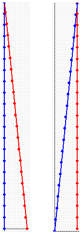

Stephanus said:

There's a reason those two paragraphs are identical: your two scenarios are identical except for who accelerates. You can tell if it was you who accelerated because you'll have felt the force. If you were somehow incapacitated during the acceleration phase, you have no way to know if it was you who accelerated just now, or the supernova that accelerated 1000 years ago.
None of the above is relevant to the twin paradox.
The space-time diagrams you've been drawing with Mentz are effectively maps of space-time, showing where and when things happen and tracing out how they move. The Lorentz transforms relate the map drawn by one person to the map drawn by another in relative motion. All the stuff about length contraction and time dilation and the relativity of simultaneity and differential aging is there.
All the stuff about light travel time is an additional layer of complexity on top of that. I strongly advise you not to worry about it until you've got the maps sorted out. Make sure you understand the terrain on Google Maps before you switch to Street View, or you'll just get lost.
Yes, we cannot know the supernova has started moving until it's light reaches us. That does not stop us from, after the fact, drawing a map of what must have happened. Here is a pair of space-time diagrams showing us in blue and the supernova in red. I have added dots every 500 years on each worldline.
In the left-hand diagram, the supernova is in motion and we are at rest. Note that the red dots are slightly wider spaced than the blue ones because of time dilation - there are 20 red dots and 21 blue dots. In the right-hand diagram, we are in motion and the supernova is at rest. In this frame our clocks are time-dilated, but we started them early - so there are still 20 red dots and 21 blue dots.
I haven't drawn on any light pulses because they aren't necessary to understand what's going on with the clocks. I repeat that I would advise not worrying about them - I think you are confusing yourself by trying to sort out the details of what we would see without having a grasp of the big picture.

Green is green line from previous graph.
Blue is at (0,17) because ##\sqrt{23^2 - 11^2} = \sqrt{408} = 16.94##
The 'shape' is right. Blue stays at x=0, green approaches and the line that was at 0,0 moves to the right.
The proper time on Blues clock is about 20.2 (counting the dots) but on your diagram the time on Blues clock is about 17. That is not right. They should be the same.
If you want to transform the diagram to Blues rest frame, you should transform the points A,B,C with a Lorentz transformation with velocity -v where v is Blues velocity.
I transformed B ( t=23, x=11) with ##\beta=-0.478, \gamma=1.138##
##x'=(11)*1.138-(0.478)*(1.138)*23=0.005##
##t'=(23)*1.138-(0.478)*(1.138)*11=20.2##
There are rounding errors but you can see that ##x'## goes to zero.
I'm encouraged that you seem to be understanding worldlines. If you complete the transformation for B and C then on the new diagram you will see
1. Invariance of proper times
2. Relativity of simultaneity.
It is worth doing.
What? ##\sqrt{408}=16.94##? Not even 20?? I must have dozed off. Argghhh.
Yes, yes. You don't have to convince me. Rounding errors. But as I said, when I get back to my own computer, I'll do the calculation again. I think the green line is not right. My green line.
##\sqrt{408} = 16.94## Arghh
'Arghh' indeed.
These diagrams are fairly accurate but not the same numbers. I won't be available for a while now.
