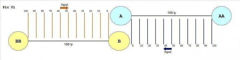

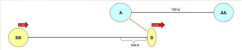

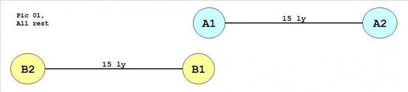

There are 4 probes.
Clocks are synchronized and reset. Time = T0
Their distance is 100 lys according to Pic 01
It's been 100 years since the clocks are synchronized and reset.
They have been sending digital signals.
The signals contain respective time and status, the time when they fire their rocket.
Then BB and B, preprogrammed, fire their rockets for 1 second, catapult them for V and stop.
A would have said. "Wow, B is traveling 86.6%c, but BB still stays". Is that right?
Because there's no way that A will know that BB has fired its rocket.
And after 10 years in A clock, will A still consider BB still at rest?
Because A only receives BB time and status, which is the rocket has never been fired, yet.
Does A still see that BB hasn't been contracted yet, and sees that B is already contracted?
Does A read BB clock showing T0+10 years?

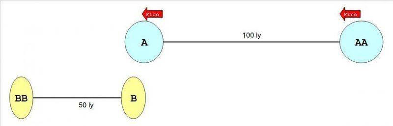

Would A see Pic03 the instant if rocket B and BB are fired and shot at V?
B is contracted while BB isn't, is this the right picture?
What if rocket A (and AA) is fired?
Would A see Pic04 the instant A (and AA) is shot at V?
Both BB, B and the distance is contracted by 50%
Does this why twins paradox occur.
Because in both cases the distance between A-AA and B-BB decreases but there is asymmetry?
A cannot see (in the literal sense of receiving light signals) BB moving until light signals emitted by BB after he starts moving reach A. Does that answer your question?
Again, A cannot see (in the literal sense of receiving light signals) BB moving until light signals emitted by BB after he starts moving reach A. Does that answer your question?
A does not see (in the literal sense of receiving light signals) either B or BB as contracted. If B is large enough that light signals from different parts of B take significantly different times to reach A, then A will see (in the literal sense of receiving light signals) B as rotated (google "Penrose-Terrell rotation"). Similarly for BB, when light signals from BB emitted after he starts moving reach A.
A sees (in the literal sense of receiving light signals) BB's clock showing whatever reading was on BB's clock when the light signals were emitted.
A does not see (in the literal sense of receiving light signals) the distance from BB to B. A only sees (in the literal sense of receiving light signals) light signals coming from B and BB, with B's and BB's clocks showing certain readings. A can deduce the distance from BB to B, at some instant of A's time, only by using additional information: what A knows of BB's and B's state of motion, and whatever simultaneity convention A is using.
See above on "seeing" length contraction.
See above on "seeing" distances.
No.

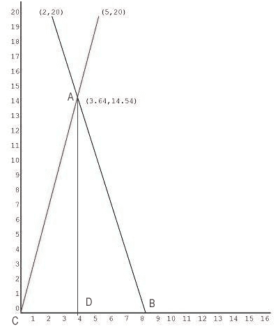

No one can se a Lorentz transformation. It is an abstract formula that connects the rulers and clocks of 2 coordinate systems in inertial motion wrt each other.
What you will see if another something approaches you is blue shift in the light they send towards you. From this you can say that their clocks are running faster.
If they are receding from you then you get the opposite - their clocks are running slower. That is the physical facts.

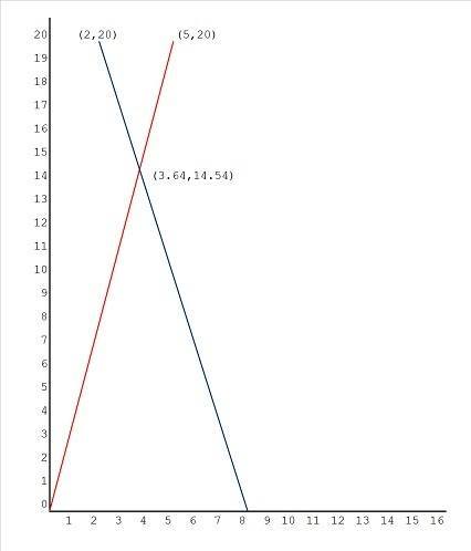

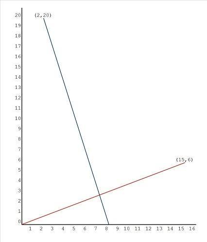

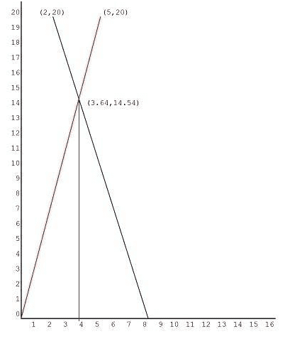

Have another look at the diagrams ghwells made earlier.
