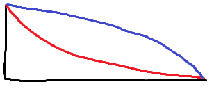

A ball falls from the top of 2 slopes of the same length as shown. No friction and no assumption of the convexity of either curve (they might be convex and concave at various locations, but the blue is always above the red). Which schematic solution is the best in showing that it falls from the red curve faster?
mechanical energy conserved
What are your thoughts? We cannot help until you have showed some effort yourself.
One can use variational calculus, but I'm looking for a graphical solution.
You'd have to figure out what to graph, which may be easier once you have solved it algebraically.
Time passing the path interval [l,l+dl] is
[tex]dt=\frac{dl}{v(l)}[/tex]
where l is length parameter of the path and v(l) is tangential speed as function of l.
By conservation of energy v(l) = v(y(l)) where y is vertical coordinate of the path and y=0 at start top l=0.

But it is not necessarily the case that ##v_{lower}(l)>v_{higher}(l)## for all l.
We shall investigate integral
[tex]T=C \int_0^L \frac{dl}{\sqrt{-y(l)}}[/tex]
where y(0)=0, y(L)=-H.
For path 1 and path 2, in the case ##y_2(l) > y_1(l)## for all l, obviously ##T_2 > T_1##.
