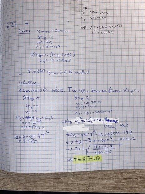

A rocket is launched from the surface and reaches a maximum height of 960m. The rocket’s engine gives an 16m/s^2 upward acceleration during time T. After that time T the rocket is in free fall.
What must be the value of T in order for the rocket to reach the required altitude(of 960m)?
Getting the solution was no problem.(steps included in picture)
My question is how I could go about reasoning whether the solution of the problem makes sense without actually looking at the solution in the back.
Here f.e. T=6.75 for the ‘first’ stage, how can I reason/evaluate this without looking at the solution?
My guess is that I could compare it to the time interval of the free fall motion(stage2).
Would that be enough to let it make ‘sense’?
As we know that stage 1 has an acceleration of 16m/s^2 and free fall one of 9.81m/s^2. Then.. is it sufficient to reason that the time needed to complete stage 1 will be less than the time need to go from the start of free fall to the maximum altitude?
THANKS IN ADVANCE!

Think of fireworks.
The way up is much faster than the way down.
There is a much more abrupt change of velocity (launch to zero) during ascension (greater acceleration).

Thanks! And thanks for answering as well.
Oooh okay yeah so that is the kind of reasoning to make.
So just to clarify.
In the evaluating part of a problem, I don’t really need to spend a lot of time here. It’s just about checking whether the answer makes sense as as an example, the problem above: if the ascending time would be bigger than the free fall one, it wouldn’t make sense and I’d need to revise my solution. And even after making this evaluation the answer could still be wrong but I will at least have a little certainty that it is at least a step in the right direction, correct?
I'm having trouble understanding this question. If you don't look at the solution in the back, then it seems you can't go about reasoning whether the solution makes sense, because you don't know what the solution is!
If you're trying to develop the reasoning skills then you have to solve the problem without looking in the back. Then you can look in the back and compare the solution you see there with your solution. It takes practice to develop this skill but it's a skill necessary for your success.
You're taking the right steps, you just need to explain why. So, for example, you calculate that ##v_y## is 16##T##. But you don't explain that that is the velocity when the engines shut down. You can take the value of ##T## that you calculated, multiply it by 16, and see if that's a reasonable value for the speed at that time.
Hi @simphys. Welcome t PF.
Your solution looks OK - except you have written
960 – 8T
instead of
960 – 8T²
but I think that you have used the correct value ( 960 – 8T²) subsequently.
Why not simply use the value of T to calculate the final height. Not a lot of work:
##Δy_1 = 8*6.75^2##
##v_1 = 16*6.75##
##Δy_2 = v_1^2 / 2g##
Do ##Δy_1## and ##Δy_2## add up to 960m?
There are lots of ways to do this problem. If you do it two different ways and get the same answer that's a good sign. Here's perhaps the wackiest way to do it.
The times ##T_1## and ##T_2## are in inverse proportion to the acceleration ##a## and ##g##, so that:
$$T_2 = \frac a g T_1$$The distance is the overall time multiplied by the average speed:
$$D = v_{avg}(T_1 + T_2) = v_{avg}(T_1 + \frac a g T_1) = v_{avg}T_1(\frac{g + a}{g})$$The average speed is the same for both legs(!), hence:$$v_{avg} = \frac 1 2 aT_1$$That gives:$$T_1^2 = \frac{2Dg}{a(a+g)}$$Wouldn't it be amazing if that gives the same answer?!
I am awed by wacky but I prefer short and simple.
For the powered leg of the journey
$$h_1=\frac{1}{2}aT_1^2$$ $$2a \left(\frac{1}{2}aT_1^2\right)=v_1^2$$For the free fall leg $$2g\left(D-\frac{1}{2}aT_1^2\right)=v_1^2=2a \left(\frac{1}{2}aT_1^2\right)$$ $$T_1^2 = \frac{2Dg}{a(a+g)}.$$

Oh yes, most definitely! I completely agree, so let me clarify a bit. I am talking about the reasoning before looking at the solution, haha.
The way I do it is solve a problem, then look at the back and either resolve if it gets too messy or look at the mistake I made like you stated.
But suppose that you need to calculate f.e. the velocity in the real world, you can’t just look at a solution to compare it with. You’d need to use your own intuition on whether it’d be correct after making the calculation. But like you said, that takes practice..
As to why i asked the question
What Happened was.. I was just about to start kinetic energy when I realized that I don’t really think about my solutions itself(no matter wrong/correct) before looking at the Endofbook solution. Hence why I started from the beginning, and whether that is a waste of time or not at this point of time.. That I don’t really know😬
To be even more specific, I was doing exercises from hibbeler’s dynamics book from university which were chapters about kinematics and kinetics. I kid you not every exercise I did was wrong, but was 100% in the math, mostly how i chose the signs relative to the datum lines. Thus.. this made me skip this exam and learn it on my own with a more beginner friendly book

Thanks a lot!
ooh! Yes.. thanks once again. Well.. I didn’t really think about this relation. That’s indeed the simplest one I could’ve used to check the answer. But something like thid to check the answer to make sense, do I need to do that on every exercise or not really?

The simplest solution is to draw a graph of speed against time, where the total area is the distance ##D##. There's a lot that you can see straight from the graph:
From the graph it's obvious the speed at the end of the acceleration phase is the starting speed at the beginning of the deceleration phase. I.e. $$v_{max} = aT_1 = gT_2$$It also shows the symmetry that the deceleration phase with ##g## has the same shape and area (distance) as would an acceleration for the same time ##T_2## with positive ##g##.
You can also see that the average height of each triangle is the same: it's half the maximum height. I.e. both legs have the same average speed, which is half the maximum speed:$$v_{avg} = \frac 1 2 v_{max} = \frac 1 2 aT_1 = \frac 1 2 gT_2$$And, of course, the total distance ##D## is given by the sum of the areas of the two triangles, which is ##\frac 1 2 \times \text{base} \times \text{height}##:$$D = \frac 1 2 T_1(aT_1) + \frac 1 2T_2(gT_2) = \frac 1 2 aT_1^2 + \frac 1 2 gT_2^2$$To solve the problem, we just need to substitute ##T_2 = \frac a g T_1## into that equation.
