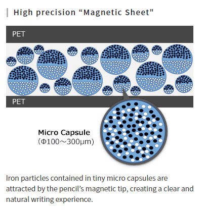

Hello, you're absolutely correct. This refers to a colloidal solution where TiO2 is intended to be suspended. After conducting some research, I have focused on formulating a microencapsulated suspension of TiO2 and Fe3O4 nanoparticles for use in magnetophoretic displays.
While I understand the necessity of using a suitable dispersant and anti-settling agent, I'm facing difficulties in identifying the most appropriate options. If you happen to know any interested individuals or experts, I would be grateful if you could provide their information. I am willing to create a freelancing job request on their preferred platform, and they can assist me in this matter. Please inform me if you have any leads.
Isopar M is a fairly low viscosity fluid. Have you tried using something thicker?
Have you tried adding the Fe3O4 to the mixture that you have created and encapsulating it? It may have different properties in that physical configuration.
