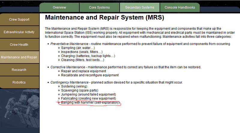

TIL, while browsing http://isslive.com/operations.html I learned that I have the training to perform at least one aspect of "contingency maintenance" aboard the ISS
(This is a useful site for space geeks)

But can you bang with a hammer transferring an impulse of 0.6 kg m/s within 10% tolerance?

TIL, that, IMHO, hammers, in all their incarnations, are most awesome tools.
Pepper Mint
- 91
- 139
Greg, TIL a Mexican of C++ gave your PF mobile product only 3 stars
Stephanus
- 1,316
- 104
Borg said:Seems like overkill unless the U.S. thinks that North Korea is using iPhones to guide their missles.![]()
@mfb beats me. That's what I'm going to say. I concur.mfb said:Using commercial devices would certainly be more convenient than writing the software on your own. But yeah, if you can make a nuclear weapon and an intercontinental missile you can probably write code to determine your location and speed based on GPS signals.
Stephanus
- 1,316
- 104
Hammers? But I think ISS is mostly United States', (although the "I" stands for International) not Russian's.1oldman2 said:TIL, while browsing http://isslive.com/operations.html I learned that I have the training to perform at least one aspect of "contingency maintenance" aboard the ISS(This is a useful site for space geeks)
I can't help but remember a scene in Armageddon Movie.
There's a malfunction in "Freedom" shuttle ship. And here's the dialog between two astronouts.
American: Don't touch that you don't know American components.
Russian: American components, Russian components all made in Taiwan!
And the Russian produces a hammer, bangs it twice and voila! It starts.
