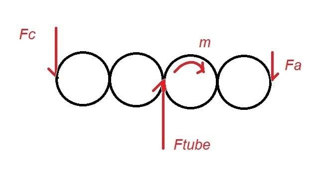

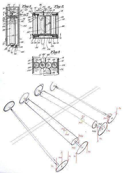

Hi there,
I'm trying to get a grip on this 1930's toothpaste dispenser. The basic idea is that you place a tube in de dispenser between the rollers, and then rotate one of the rollers with the key in order to dispense some toothpaste. Since the gears are connected to the first roller, the other roller also rotates and also the entire carriage moves downwards since two gears are connected to the racks on the side.
My question:
when we have an equilibrium of the whole carriage and we visualize it from the side, 3 forces and one moment are there: 2 forces on the intersection of the two side gears whith the racks (Fa & Fc), the moment (m) about the roller and the resultant force of the tube on the roller. (ALL other forces drawn are internal to the carriage)
Since the moment on the roller is not in the centre, Fa =/= Fc, and so the resultant force of the tube (the two blue ones) is not equal to zero since Fa+Fc+Ftube=0.
But if we assume that the tube itself is just hanging there (which is possible), the tube itself ONLY undergoes the opposite force Ftube, so it can't be in equilibrium!
Since it seems like a possible situation, something in this scenarion isn't right. I hope someone can help!
thanks!

I don't think you're including all the forces that the rollers apply to the tube.
They are probably "stretching" the tube by pulling the top of it upwards (via friction with the rollers) and pushing the bottom of it downwards by the rollers being driven into the wider toothpaste-filled part of the tube. That latter force seems to be the only one you included.
So there could easily be no net force on the tube.

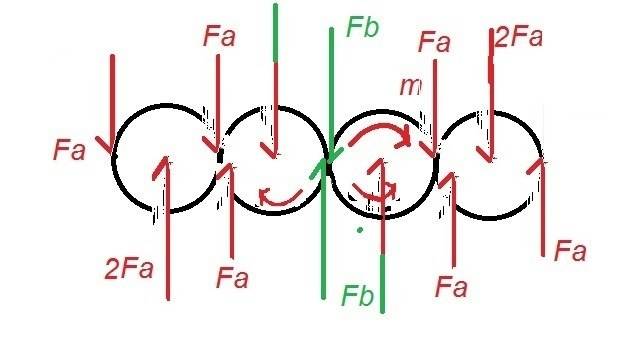

Unrest:
Yeah since we concluded the tube won't aply any vertical force, Fb and Fa should be opposite and equal to compensate the moment. In this image I draw this situation, every gear isolated (but positioned next to each other.) We threat the friction as a (small) moments applied against the direction of the roller (and thus the gear).
Fb=Fa, zo i called everything Fa, I use Fb for a new force now
Still there is something wrong!
the 2nd gear from the left is subjected to the moment of the roller, therefor Fb>Fa. Fb acts opposite on the 3rd gear, which is also subjected to Fa: but the difference between the 2nd and the 3rd gear is that the 3rd gear is subjected to two moments
In other words: the fact that we subject only ONE of the rollers to a moment, should cause the rollers to produce a-symetrical moments.
is this correct?

Oops. I retract my statement in post 5 where I said Fc equals Fa. I currently agree with the original statement by thijsdb in post 1, that Fc ≠ Fa, when m > 0 (regardless of whether m is in the centre or not). I still agree that the second attached file in post 1 is correct.
I would say, limit the question to only one load case, for now -- the load case when the tube is not just hanging. Assume friction is zero, for now. Then try to solve for the unknowns (Fa, Fb, and Fc). The problem is, there currently appears to be three unknowns, but only two statics equations, unless I am missing something. I have not quite figured that out.

No, the rollers are locked together by the gears, so they're both turned. The tube won't know which one the key is attached to. If it somehow applies more resistance to one roller than the other then that roller's shaft will carry more torque, regardless which one it is.
I think your most recent picture is fine. It also gives balanced forces on the carriage frame. And by balancing moments on the carriage frame you can show that Fa/Fb = 3/5.
You are right, I thought the 3rd gear was not in equilibrium, but i didn't look properly at the directions of the moments and forces on the 3rd gear.
Naming the small drawn moments 'msmall' We can also conclude that m - msmall = msmall, hence m=2*msmall from the 2nd and 3rd roller.

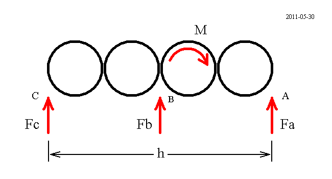

I redrew the diagram (attached) such that positive is upward for all external forces acting on the carriage assembly. Fb is the resultant external force exerted by the tube on the carriage assembly. The distance between the side racks is h; and h = 4*d, where d = gear pitch diameter.
For load case 2, let's say bearing friction is zero, but roller friction is high, such that the rollers do not slip. And as stated earlier, for all load cases, the tube is weightless. Therefore, for load case 2, the solution is Fb = 0, Fa = M/h, and Fc = -M/h.
For load case 1, the solution is,
Fa = -0.5*Fb + (M/h),
Fc = -0.5*Fb - (M/h).​
The problem is, you do not know Fb. I think load case 1 might be statically indeterminate. Perhaps the only way you can determine Fb is to apply a moment M, then measure Fb. After you obtain Fb, then you can compute Fa and Fc.

Yes indeed load case 1 is statically indeterminate, that is i think the problem stated in the #1.
Load case 2 is the one I drew in my last picture and which Unrest is referring to in #11.
For me this is fine, since the load case 1 only occurs if the roller friction is NOT sufficient and the rollers slip: the carriage then will nonetheless move downwards because of the gears/racks, crushing the tube ..
So what I'm saying is that in case 1: Fb=/=0 ---> tube slips
Because if the tube doesnt slip it gets pulled through with the same speed as the carriadge is moving down*, so the system won't push the tube down --> Fb=0
