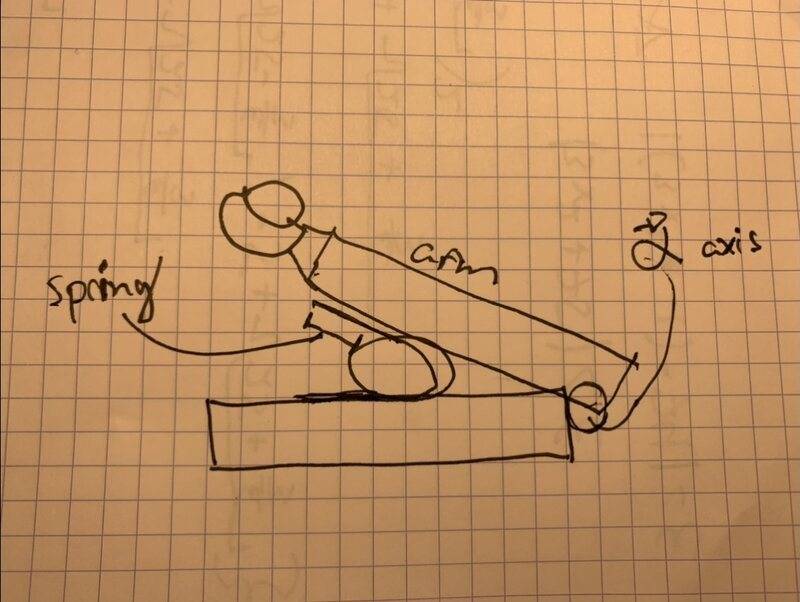

Tangent aside, I was hoping to build a tiny little mangonel catapult in the next month or so as a way to apply what I have learned so far. The first thing that came to mind was to get a torsion spring, and store energy by compressing one end with the swinging arm. I figured that would involve applying the spring force over a length (as in the spring is literally in contact with several centimeters of the arm), as opposed to just a single point.

If I understand this right, the end of the spring is rounded and fits into a rounded slot in the arm. So the "point of contact" is spread out over several centimeters.
You have a figure for the force applied by the spring in mind. You do not know how much torque this amounts to. You want to multiply by the length of the moment arm to figure it out. But you don't know where within that rounded slot to count as the end of the moment arm.
If it were me, I'd probably make force measurements at the far end of the lever and judge torque from that. And maybe make some control measurements. How much variation in force required before the hinge budges either way. How much support force required if the spring is removed? Are there any places where anything is binding? Maybe some high speed video to measure acceleration.
But I may not be clear on what you think you know and what you are trying to calculate from that.
I made a very crude drawing, but I think that we are roughly thinking along the same lines.

I had figured that I would use rotational work to find the KE it would have at whatever optimal angle, and use an approximation of rotational inertia to find angular velocity, and then the projectiles tangential velocity.
Like you suggested, the plan was to use my phone's 240fps video mode and record a launch in front of some reference point. Then I'd compare my predictions with the footage.
The springs come with a measure of their max torque, and I'm assuming the torque is a measure of the spring force at the very end of one of the uncoiled segments. I'm not too sure how I'd convert that to a linear(?) force that would be applied to the arm.
How does one go about taking force measurements, in this instance? Would I just get one of those force sensors and estimate things through trial and error?
It is called a helical torsion spring. In your design I wonder one arm of the helical torsion spring cannot keep contacting not on a point but full contact along the bar to the arm of catapult during the motion. If you allow the contact is on a point of the end of the spring arm, your difficulties would be lessened.

My only concern is that I am not sure how I'd accomplish that without bending and possibly fatiguing the spring arm. Maybe with the actual materials in front of me I'd have a better idea. It seems like it would be simplify the torque calculation a fair bit, though.

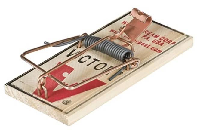

Some experimenting with a torsion spring catapult will help answer your questions. And you can get a torsion spring complete with catapult arm, release mechanism, and mounting base for a few dollars at your local hardware store:
Photo of a wooden mouse snap trap with a copper-colored torsion spring, a bail wire and a metal trigger arm, with red and black printed text on the wooden base.
The mousetrap design is especially easy to analyze since the point of application of the spring to the trap does not matter. The axis for the spring coincides with the axis of the trap.
