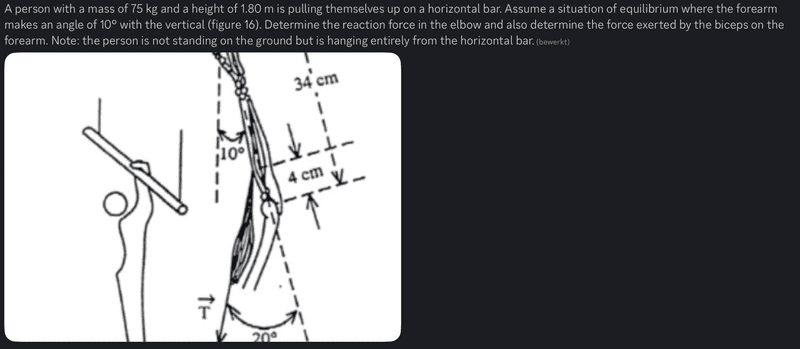

I eventually calculated, using the moment, that the force exerted by the biceps is 1536 N (this is correct according to the model solution), but the calculation of the reaction force is more difficult. I was able to decompose the following forces into x and y components:
Fx Hand = 1.08 N
Fy Hand = 6.15 N
Fx Arm = 2.68
Fy Arm = 15.25
Fx Biceps = 125
Fy Biceps = 345
I'm unsure about the force in the rope; in the drawing, it's horizontal with the arm, so I thought the rope would only have a y-component.
But I also tried it with a 10° angle, and then my calculations still don’t work out.
→ Normally the force in the rope should be 367 N ((9.81 × 75)/2)."
I'm getting 1588 N for T in each arm, assuming both arms are loaded equally. This is ignoring the weight of the forearm & hand (since they are not given).
Ignoring the weight of the forearm & hand you have 3 force vectors acting on the forearm & hand:
Fbiceps = T at 10° to vertically down
Fbar = half the bodyweight vertically up
Felbow = contact force acting on the forearm in the elbow
These 3 vectors must add up to zero in both, X and Y direction. Then you solve this equilibrium equation for Felbow and compute its magnitude.

Sorry forgot to add the weight of the arms and hand:
1. mHand: 0,64 kg
2. mforearm: 1,58kg
3.mupperarm: 2,48kg
And how/why can you ignore the rope force?
1. mHand: 0,64 kg
2. mforearm: 1,58kg
3.mupperarm: 2,48kg
Upper arm mass is not needed. Your vector equilibrium equation then also must include the combined weight of hand and forearm pointing vertically down.
What rope? The person is hanging from a bar, see Fbar.

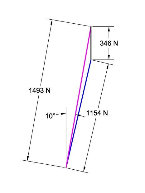

The OP was incomplete: The forearm & hand are not massless (see post #3).
But then I think the center of mass of forearm & hand should be given as well. Or are we to assume it's in the middle of those 34cm?
The posted picture does not offer that additional information.
Then, maybe we should subtract those above-elbow four masses from the given total body mass.
Incorrectly perhaps, I just assumed no torque at shoulders or hands, and therefore similar lengths for elbow-hand grip and elbow-shoulder.
Then, I did the summation of forces at the elbow that is able to keep the shown static geometry.
Redoing it subtracting the above-elbow four masses from the given total body mass, I now get 94% less of each force:
The tension force should be 1493 N for each bicep.
The longitudinal compressing force in the Humerus bone should be 1154 N.
That value is far from the 1536 N according to the model solution.
