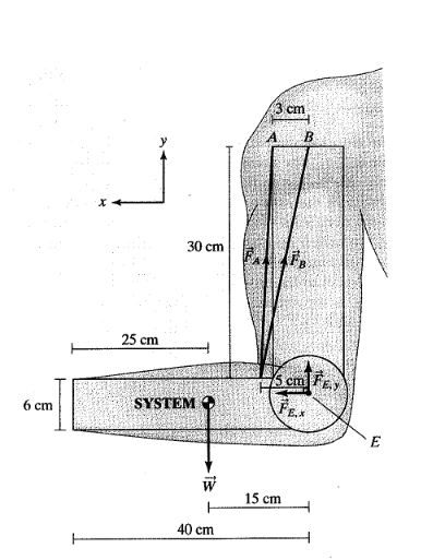

Please let me know if I did this wrong or right, and if I did it wrong, please correct me :)
1. Homework Statement
The biceps brachii, a muscle in the arm, connects the radius, a bone in the forearm, to the scapula in the shoulder (see below). The muscle attaches at two places on the scapula but at only one on the radius. To move or hold the arm in place, the biceps muscle balances the weight of the arm and the force at the elbow joint. The centre of mass of the arm is at 15 cm from the elbow joint. The horizontal force of the elbow joint is 6.5 N when the forearm is held parallel to the ground and the forearm weighs 15.3 N. If the biceps supports the entire weight of the forearm, calculate the necessary force from each branch of the biceps to hold the forearm parallel to the ground and the vertical force at the elbow.
Free-body diagram of a forearm and upper arm: forces F_A and F_B along the biceps branches, weight W of the system at the wrist, and elbow reaction components F_E,x and F_E,y at point E, with dimensions 25 cm, 30 cm, 6 cm, 40 cm, 15 cm, 5 cm and 3 cm.

That all looks right. To see whether the vertical force should be up or down, consider moments about the point where the muscle attaches to the radius.
Thanks for responding! Was my use of trigonometry correct, particularly when calculating the moment arms? I neglected the 6 cm width of the forearm, not sure if it was okay to do so. That's where I had a bit of uncertainty. Also, in retrospect, FEy should be negative; the elbow ALWAYS exerts a net downward force in this configuration.
The 6cm width is not in itself relevant, but your working is not quite accurate because the point of attachment of the muscle to the radius is slightly above the joint. The height difference is unclear - it looks to be less than 3cm.
Thank you, that is precisely where my uncertainty lies in my attempt to solve the problem. Do you know of a more accurate way to solve the problem than assuming a height differential of, say, 2.5 cm? That is, I would instead use "(5.6 cm)sin(86.19 deg)" and "(5.6 cm)sin(80.54 deg)", respectively, when calculating MAA and MAB, where the "5.6 cm" is obtained via
c2 = a2 + b2
c2 = 52 + 2.52
c = 5.6 cm
The other uncertainty is the assumption that points B and E are in vertical alignment. What do you think of this assumption? Is it necessary to solve the problem? Valid?
Many thanks for helping me out!
By assuming a height differential of 2.5 cm between E and the point of insertion of the biceps into the radius (i.e., a distance of 5.6 cm between E and said point of insertion), I get FA = 3.26 N, FB = 38.24 N, and FEy = 25.67 N [down]. Can anyone verify this? Thanks!
