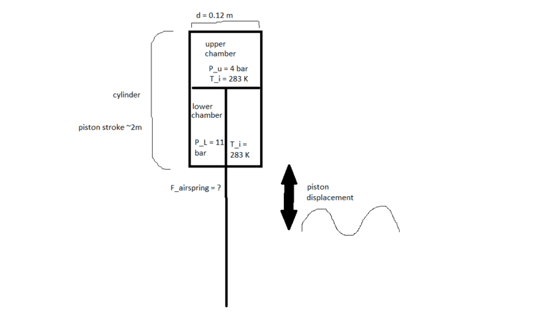

I might be able to help because I have some experience with fast moving air pistons. But first, I need more information. A simple sketch of your system. A description of what is moving what, and how fast. Approximate sizes and strokes - a 0.1" diameter piston is not the same as a 10" diameter piston, depending on velocities and displacements. What is the steady state pressure? Do you know the peak pressures, or is that what you are trying to find? Does the air spring bottom out at either end of the stroke? Is one of the project goals to bottom out without slamming or bouncing?
@jrmichler , yes I attached a photo. I will keep things a little vague as this is an ongoing project.
More generally what is happening is the piston rod is attached to a device that moves it in an irregular sinusoidal heave motion (emulating ocean waves) so everything is moving pretty slowly actually. The air spring's purpose is to act as a restoring force. Estimate speeds of ~ 1 m/s.
Although slightly different, the piston diameter is ~0.12 m in each chamber. The total stroke is ~ 2 m. Initial starting position is ~ 1m.
I don't know the steady state pressure or temperature, but I do know their initial values, upper chamber ~ 4 bar and lower ~ 11 bar. Initial temp in each is 283 K

Since this is a real world problem, we start with the simplest practical model, then add complexity only if necessary. Even then, we only add enough complexity to make the model work "good enough". Since it is slow moving, ignore temperature. Ignore piston and rod seal leakage.
Then ##Pressure * Volume = Constant##. You know the volume of each chamber from the piston position, and you know the pressure at the starting volume. Therefore, you can easily calculate the pressure at any other piston position. Note that the piston rod area reduces the area of the piston on the rod side. The rod force, ##F_{airspring}##, is the lower chamber pressure times the rod side piston area minus the upper chamber pressure times the upper side piston area. It's pulling the piston rod upward at a little less than 8000 N in the starting position shown.
As a cross check on your simulation, the rod force should approach infinity when the piston approaches either end of its travel. In practice, something will get destroyed before that point, so the system needs to be designed so that destruction does not happen.

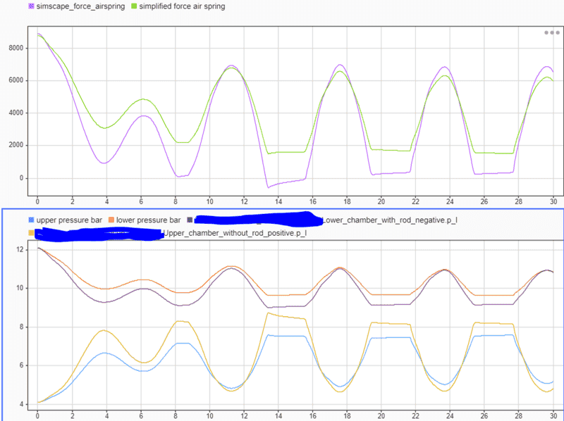

I have a simscape model to compare my more simplified forces to, and so far the force from the airpspring between F_simple and F_simscape compare OK? I guess I would need to see how a difference of 1200 Pa (the largest difference between the two signals) has on the entire system and if ~1000 Pa is even a big difference or not in the world of pressures. (We are working towards simplifying things b/c eventually the complex model takes e-20 time steps, too long to wait).
Would things like heat transfer, leakages, friction, be added for more complexity? I would still like to account for heat transfer, but am unsure how to tackle that.
