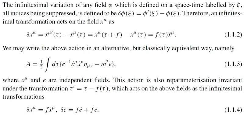

In West's book "Introduction to Strings and Branes", page 2, I don't understand why the auxiliary field e transformed as e'([itex]\tau'[/itex])d[itex]\tau'[/itex]=e([itex]\tau[/itex])d[itex]\tau[/itex].
Printed text from a physics textbook giving the infinitesimal variation of fields, equations (1.1.2) x^mu variation and the action A = 1/2 integral dtau (e^-1 xdot^mu xdot^nu eta_mu nu - m^2 e), and reparameterisation transformations (1.1.4) delta x^mu = f xdot^mu, delta e = f edot + fdot e.
By construction :-)
You impose several conditions on your action and then get how auxilary fields should transform. Just like with YM gauge field, you want gauge invarianceand from this you get transformation law
