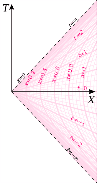

which of course is undefined at X=0. I can see why this would be the case when T>=0 since a beam of light coming from the positive T axis never touches the accelerating spaceship hyperbola, but it appears that such a beam would indeed intersect the hyperbola if T<0. Why then would that point of origin (X=0, T is negative) also be undefined to the accelerating observer?
Have you seen the picture of the Rindler wedge at the article? The coordinate system doesn't cover ##X=0##. It's valid where ##|T|<X##

A couple of things to note that make Rindler coordinates much less confusing:
With reference to the above chart from the Wikipedia article ,, the diagonal line marked t=1 represents the line of simultaneity of the accelerating Rindler observers with equal Rindler coordinate time t=1. They do not have equal proper times. The t coordinate used in the Rindler coordinate system is not the proper time of the individual accelerating Rindler observers. An accelerating observer (A) on the x=1 parabola will see a second accelerating observer (B) on say the x=0.6 parabola as stationary with respect to himself at all times yet he will observe the natural clock carried by B to be running much slower than his own clock. If the two accelerating observers synchronise their clocks using the Einstein clock synchronisation convention, they will be out of sync again a very short while after. To create a sensible coordinate system in the accelerating Rindler reference frame, the proper times of the spatially separated observers have to be artificially adjusted so that they all run at the same rate. as a single clock somewhere on the positive X axis that is chosen to be the master reference clock of the accelerating observers. This master clock is often chosen to be the clock of the accelerating observer that passes through X=1 for convenience. The diagonal line t=1 also represents a line of equal velocity where all accelerating observers on that line have a velocity as measured in the inertial reference frame of [itex]x^2 - c^2t^2 = r^2[/itex]. At any time T (except zero) according to the inertial observer the accelerating observers have different instantaneous velocities, with the ones nearest the origin moving the fastest.
The general transformation formulas that you requested are given by equation (2a) in the Wikipedia article but Wikipedia uses X,T for the inertial coordinates and x,t for the accelerating coordinates which is the opposite of the notation you introduced in your first post.
Hope that helps.
Note credit to Dr Greg for creating and making the Rindler chart freely available on Wikipedia :wink:
