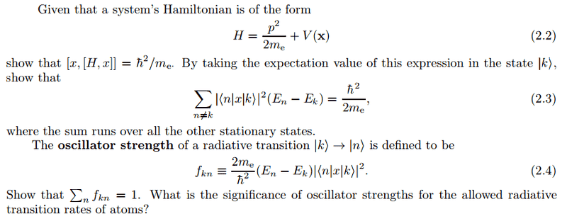

Part (a): Show the Commutation relation [x, [H,x] ]
Part (b): Show the expression by taking expectation value in kth state.
Part (c): Show sum of oscillator strength is 1. What's the significance of radiative transition rates?
Part (a)
Manged to show.
Part (b)
[tex]\langle H \rangle = \langle k|\frac{p^2}{2m} + V|k\rangle[/tex]
[tex]\frac{1}{2m}\langle k|p^2|k\rangle + \langle k|V|k\rangle[/tex]
Not sure what to do at this point - it looks nothing like the answer.
Instead of taking the expectation value of equation (2.2), take the expectation value of the commutation relation that you showed in part (a).
I tried and that leads to nowhere..
[tex]\langle \left[x,[H,x]\right] \rangle[/tex]
[tex]= \langle k|\left[ x, [H,x] \right] |k\rangle[/tex]
[tex]= \langle k | [x,Hx] - [x,xH]|k\rangle[/tex]
Keep going. Write out [x,Hx] and [x,xH]. Then judiciously insert the identity operator in the form ##1 = \sum_n |n\rangle \langle n| ##
[tex]= \langle k | [x,H]x - x[x,H] |k\rangle[/tex]
[tex]= \langle k | xHx - Hx^2 -x^2H + xHx|k\rangle[/tex]
Take ##\langle k | xHx |k\rangle## and insert the identity: ##\langle k | x H \hat{1} x |k\rangle##
Yeah got it!
