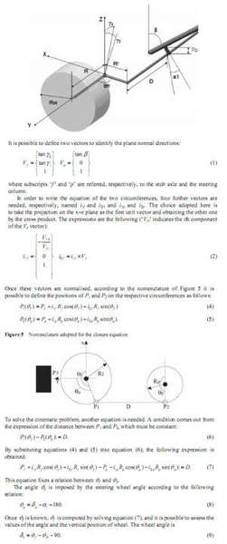

I'm still having trouble with transposing which I think should be fairly simple. The equation is solving steering geometry with two points of rotation that locates two points in space. The equation which works out the length between two points is:
D = | P1 - P2 | with | | denoting the length of the resulting 3D vector.
I know D (the length) and I also know P2 (the x,y,z position of point 2). P1 is what I'm having trouble with. The equation for P1 is:
P1 = Pf + (i1f * Rf * cos(Vf)) + (i2f * Rf * sin(Vf))
I know Pf (the x,y,z position of the axis of rotation), i1f (the x projection vector of P1's rotation axis), Rf(the length between P1 and the axis of rotation) and i2f(the y projection vector of P1's rotation axis).
From those I know all but Vf, which is an angle from P1 to the x-axis and P1, which is solvable by substituting it into the 1st equation D = | P1 - P2 |.
Vf is where I'm having the problem. How can I transpose it to make it the subject. I've tried using the identity R * cos(x - alpha) but still have the same problem of having 2 instances of Vf in the equation as in P1.x, P1.y and P1.z will all use different values for R and alpha. I hope this makes sense. If not I'll post up the images from the white paper I'm using. Any help is much appreciated.
I've attached the excerpt anyway:
Diagram of a vehicle wheel with coordinate axes X, Y, Z and steering geometry angles, showing plane normal vectors in equations (1) and (2) and position equations (4) and (5) for points P1 and P2.
Can anyone help here or point me in the right direction? I'm really stuck with this and it doesn't matter which theorem I apply, I still end up with 3 instances of x on the same side of the equation.

After simplification, you should be left with an equation of the form k = Acos(t) + Bsin(t). Using the angle addition identities, you should be able to get k = Csin(t + p) where [itex]C = \sqrt{A^2 + B^2}[/itex] and p = arctan(A/B).
Thanks for responding slider. When I expand it out, I have something like this:
k = [tex]\sqrt{}[/tex] (A.xCos(t) + B.xSin(t))[tex]^{2}[/tex] + (A.yCos(t) + B.ySin(t))[tex]^{2}[/tex] + (A.zCos(t) + B.zSin(t))[tex]^{2}[/tex]
Is there a way to simplify it because A and B are 3D vectors? I can use the Rcos(x-alpha) like you suggested but I still end up with 3 instances of t on the right side for each component of A and B.

My path was to first get the equation:
[tex]\frac{P_1 - P_f}{R_f} = i_{1f}\cos V_f + i_{2f}\sin V_f[/tex]
Then we have
[tex] C = \sqrt{i_{1f}^2 + i_{2f}^2}[/tex]
[tex]\theta = \arctan \frac{i_{1f}}{i_{2f}}[/tex]
Expanding and simplifying, we get
[tex] \frac{P_1 - P_f}{R_f} = \sqrt{i_{1f}^2 + i_{2f}^2}\sin (\arctan \frac{i_{1f}}{i_{2f}} + V_f)[/tex]
or
[tex] V_f = \arcsin\left(\frac{P_1 - P_f}{R_f\sqrt{i_{1f}^2 + i_{2f}^2}}\right) - \arctan\frac{i_{1f}}{i_{2f}}[/tex]
Edit: Oh, I see, the i's are vectors. you will have to use one of the 3 component equations.
Ok thanks. So assuming I use the x component for the equation I still have two unknowns being Vf and P1.x. Do I need another equation to work out what P1 is?
