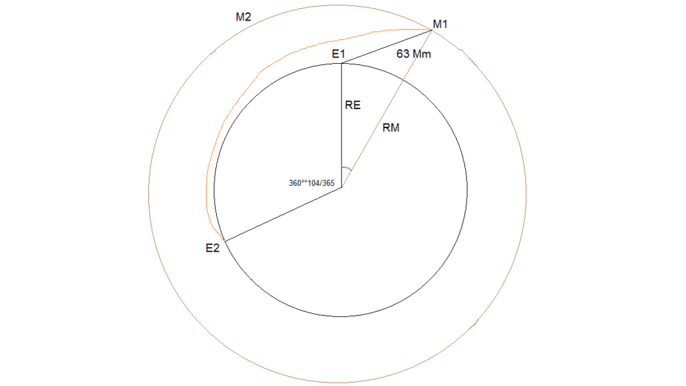

So the story is that I'm working on a piece of fiction that I want to be as accurate as possible. One part of it involves an object that travels from Mars to earth. This would have been between February 22, 1901 (beginning of opposition that year, I think) and June 7 of 1901, 104 days if i counted right. So the object leaves Mars and has to race to catch up to earth, because Earth is already moving further away. I've come up with a collection of figures, and made come calculations that I'm trying to keep as estimates... they don't need to be exact to the nth decimal point. But as i don't have the slightest grasp of celestial mechanics, I'm sure I've gotten plenty of stuff wrong.
What I'm hoping to end up with is the total distance the object would have had to travel, and how fast, to make the trip in 104 days. so here's my collection of figures (and they may be wrong, PLEASE feel free to correct me if they are!):
Mars distance from Earth 23:59:59, Feb 22, 1901 0.6774849 AU 62976155.79478 (62,976,156) miles.
Mars distance from Earth 23:59:59, Jun 07, 1901 1.3464453 AU 125159909.81 (125,159,910) miles.
Earth travels about 1.6 million miles per Earth day (1,600,000); in one hundred and four days the Earth traveled one hundred sixty-six million four hundred thousand miles. (166,400,000).
Mars travels about 1.3 million miles per Earth day (1,300,000); in one hundred four days Mars traveled one hundred and thirty-five million two hundred thousand miles (135,200,000).
‭Distance between Earth and Mars after 104 day is thirty-one million two hundred thousand miles (31,200,000)‬.
Speed traveled is 12500 miles per hour.
I KNOW I have something wrong. I'm pretty sure about the Mars distances during the dates at top... I got them off the internet, so they HAVE to be true, right? After that, the rest are averages or estimates... hopefully in the ballpark. Even so, the rest I have no confidence in. I truly suck at math, took me eight years to get through bonehead algebra in college, I'm THAT bad. So correct me! If you can look up more accurate speeds, I'd appreciate them and a citation. If nothing else, I'd like to be able to say the object left Mars on February 22nd 1901, and traveled approximately "x" miles at "x" mph, arriving at Earth 104 days later.
That is simply the difference between the distances traveled by Earth and Mars in 104 days. It is not the distance traveled by the object. That distance is the length of the orange line in the diagram. (As a ballpark estimate, I would suggest calculating the length of an arc along an orbit halfway between Earth and Mars, between the angles of M1 and E2.)
Okay, thanks, I could see the orange line in my head as I made the post, and understood that was the distance I was looking for, and needed the speed I would need to travel it in 104 days. Now, after plugging away on the internet, I have finally found that I'm looking to calculate the Hohmann transfer orbit. Yes, knowing that name would have helped in my request, but I'm a little slow sometimes. I have no idea how to calculate that curving path. When I get to work in a little bit, I will see if there are calculators for that... NASA must have something, but in the mean time folks, keep it coming! Teach me stuff!

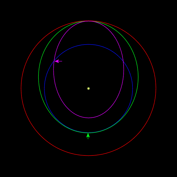

Below is a diagram of orbital trajectories. Blue circle is Earth orbit, Red circle Mars orbit.
The green ellipse is a Hohmann minimum energy transfer orbit. Your craft will intersect Earth's orbit at the Green arrow after ~258 days. What you want is a trajectory more like the violet ellipse. It full orbit would pass inside the Earth's orbit, which it crosses along the way. You time things so that the Earth and craft meet at the violet Arrow.
If you were to just completely stop your craft relative to the Sun and just let it fall in towards the sun, then it would take ~ 84 days to reach Earth orbit. You specified 104 days, so you wouldn't have to go to that extreme.
Working out the exact trajectory needed for a 104 day trip would be a bit tricky. Unfortunately there is no direct equation for determining how much of an elliptical orbit an object will travel in a give amount of time. ( there are methods, but many of them involve iteration)So even if you knew the exact shape of the orbit to start with, you need have to use one of these indirect methods to find how far you traveled along the orbit in 104 days. In your case however, the added requirement that the change of radial difference over the trip also has to be a fixed distance complicates things quite a bit more. It can be done, but it would take a fair amount of number crunching.

You know, I think you've about hit the nail on the head for me. I'd be writing from the point of view of a historian looking back on events, writing for the average reader (thus, not needing exact details). If I describe it generally as you did, with a more extreme elliptical orbit than a a Hohmann minimum energy transfer orbit, meeting the Earth in about 100 days... almost stopping the object relative to the sun and letting it fall towards the sun until it reached Earth orbit, that would be easy for a reader to visualize.
