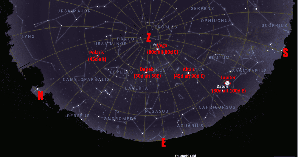

Here is the night sky for Montreal, tonight, around midnight. Facing East.
You can see Polaris, there on the left.
Other bright bodies are shown in the area you mention, along with their height above horizon and their distance from Polaris around the compass.
Jupiter is in the sky, at about 30 degrees up (you'd have a tough time seeing above the buildings), and about 100 degrees East of Polaris (in the South East sky).
The other three stars are by far the brightest in that area - together they are known as the Summer Triangle - generally the most prominent "ersatz" constellation in the summer sky.

I overlooked the chart. My star could well be Deneb or Altair, which straddle almost exactly the East sky position. Vega is in the vicinity too ( so to speak!) but it is too close to the Z to be the one I see.
Regardless, it is always there or almost. It was last winter and it is now. Hence my original question raising the parallax issues, which I am still discussing with Perok, becaue there are a few contentious points I wanted to make.

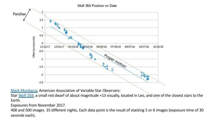

61 Cygni exhibits a parallax of about 287 milliarcseconds (or a quarter arc second). Unfortunately, this is smaller than amateur telescopes can resolve.

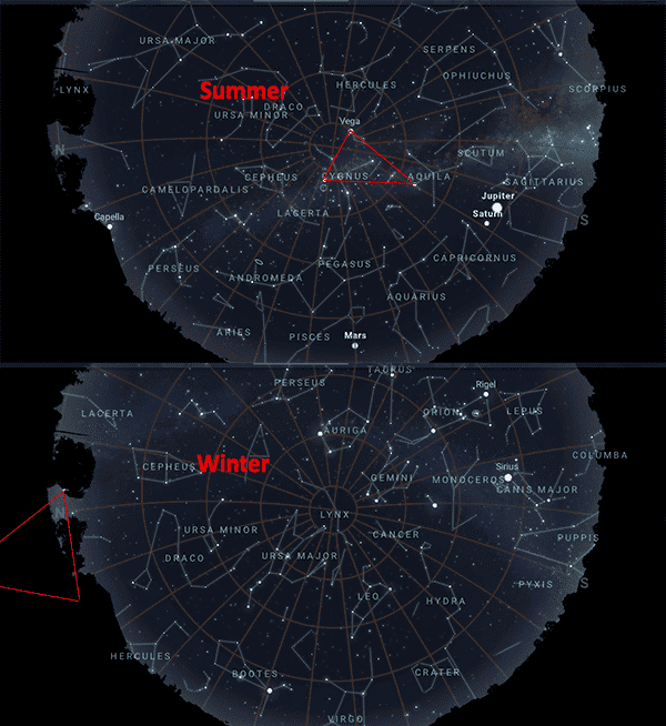

Your star:
Those stars are not visible in the winter - at least not in the same place at the same time as in summer. They're near or below the horizon at night. And they're in the North West, not South East.
Essentially, the entire sky is rotated 180 degrees around the pole star (which puts them below the horizon).
December sky, at same observing time:
You must be seeing a different star and assuming it's the same one as in the summer.
BTW, are you viewing them at the same time of night in both summer and winter? What time?

Yes. A good telescope and photographs, taken six months apart in order to make the parallax at all visible. Some while ago I was looking for a link that would actually show the results of parallax measurements in astronomy. It seems to be quite hard work because the actual movement, relative to very distant {so called 'fixed' stars) is very small . I found this graph which shows the parallax of one of the nearer stars to us. The parallax due to the Earth's orbital motion adds to the star's own motion (Proper motion) and produces the plot shown. Credit to Mark Munkacsy who was responsible for the actual work. There's another image that I found which shows what two actual photographic exposures (on a glass plate) recorded. Pretty well incomprehensible . I've no idea what the star was or what the parallax was - it just illustrates how danged clever and dedicated the old astronomers were without the help of electronics.
What you are saying, it appears, is that you saw this object now (in June), and also in relatively the same place in winter.
That cannot be so. The planets, just like the stars, will be rotated 180 degrees from summer to winter.
If you saw the object at a given time of night in the winter, you cannot be seeing the same object at the same time now in the summer. It will be near or below the horizon, and on the opposite side (North West) side of Polaris.
Likewise, if you are seeing the object at a given time of night now, you cannot have seen the same object at the same time in the winter. It would have been near or below the horizon and on the opposite side (North West) of Polaris.So, we're back to possibility #2: you are seeing a different star in the summer than you are in winter, and assuming they're the same.
I'm afraid, without further observing details, that's the best conclusion.

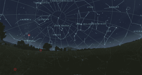

This infographic may come in handy the next time you go out.
Polaris is obscured by the brass grommet about which the inside disk rotates. The stars depicted nearby that don't go beyond the boundary of the oval window will completely traverse circularly as the disk is rotated through the year. That seems consistent with the observations that you report.
