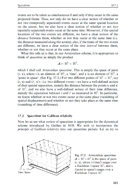

I'd add that my doubt comes from this picture of ##\mathbb E^1 \times \mathbb E^3## in Penrose book:
I believe I got the point. A trivial bundle is different from a global trivializable bundle. The former is a product while the latter is just homeomorphic to a product, however there isn't a canonical/natural homeomorphism.
So ##\mathcal A = \mathbb E^1 \times \mathbb E^3## is a product (i.e. a trivial fiber bundle). It has the two canonical projections on the factors.
Penrose then defines Galilean spacetime ##\mathcal G## as a (trivializable) affine fiber bundle over the base ##\mathbb E^1## and fibers modeled as ##\mathbb E^3##. Here there is only the projection on the base space defined by the structure. Since there isn't the other canonical projection of the product, there is no natural way to identify points on the fibers, i.e. absolute time but not absolute space.

Not following all the arguments that closely but I think I agree with Martin. Once you learn some category theory, products are defined as something satisfying a specific universal property and are unique up to isomorphism. It's fairly easy to construct "different" products that satisfy the dame universal property.
