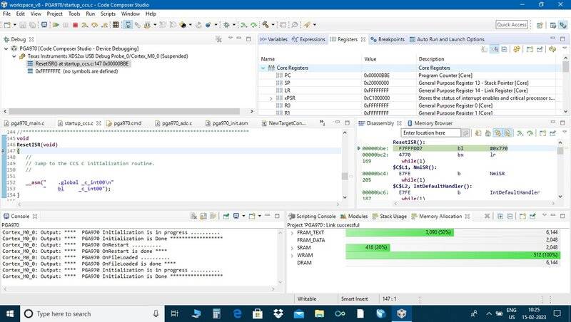

Hello,
i am programming pga970evm module and the core is of arm cortex m0. the program what i have is building succesfully , but while debugging it is stuck or halting in reset (reset_handler) and not coming out of it (startup code).
i will provide screen shot of debug page.
another thing is i cant access the breakpoints while debugging. while begugging i came to know that controller is not calling the main function since it is not coming out of reset state.
as shown in image the reset is happening at resetisr() function(startup code). if i again resume the debug it will continuously stays in same state(reset). i cant share the full code. i have included all necessary files which is required to run.
1. please can you tell me what may cause the micro controller to halt in reset state.?
2. why i cant aces the breakpoints ?
3. in xPSR i am getting exception as 010000 . does this is the reason i am getting this?
Thank you.

Does the code work when running normally? Perhaps debugging interferes with doing resets.

hello i already searched in web for this problem and contacted vendors. Their ans were not usefull. I will atach one zip file in which it shows how controller behaves when i am debugging.Please suggest any solutions.

@core7916 -- What is your experience level so far programming this uP? Have you successfully run many projects in the past, and this is the first one giving you trouble? Or is this your first project on an Arm M0?
Debuggers can often interfere with the main program -- I only run them if I have to in order to debug a problem. As jedi asks -- does your program run normally without the debugger overhead?
Alternatively, can you strip this program down to bare bones to see if that will run? If it runs, slowly build it back up to see what breaks it. If not, you must have something wrong with your build/run environment, IMO...

this is the first project i am working with microcontroller . my coding level is not good. but i am not doubting the code since i got the code from vendors. i didnt made changes to code. i am just giving the breakpoints and trying to observe what is happening inside of controller, which i cant due to above problem(reset).
Do you have the watchdog enabled? The debugger often does not stop it so you have to disable before debugging or you get a reset soon after a breakpoint.

sir, i have already disabled the watchdog timer and tried to debug, still results are same.

I have not used that processor but here are a few ideas:
First, check that the RESET input pin is not asserted! AND that there is not any electrical noise on it.
In the User Manual at:
https:\\www.renesas.com\document\man\idt-arm-cortex-m0-user-guide
See on:
pg 12, sec. 2.2.1.3.4 Program Counter (PC)
pg 94, sec. 2.4.2.4 Application Interrupt and Reset Control Register (AIRCR) and table references contained there-in.
(above user guide was the 4th listed by Google search: arm cortex m0 manual,
the PDF manual was then searched for: reset)
Hope this helps!
