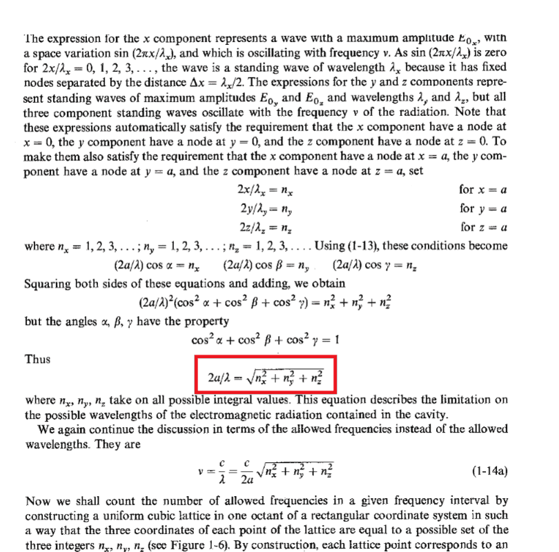

Hi everyone

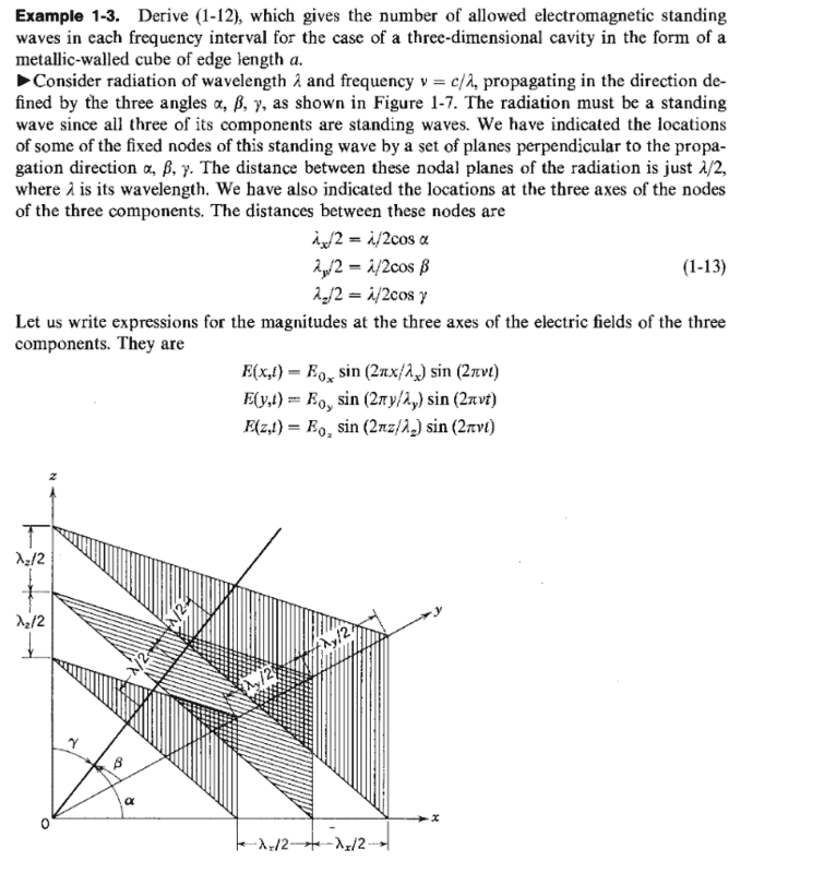

I have some trouble understanding quantum physics. Here is a scan from the book from Eisberg and Resnick
Here is how much I understand. This is radiation inside cubical cavity, λx/2 is distance from two nodes of component x of the radiation.
Same goes for y and z components. In the picture they've connected the nodes together to make a plane. I understand that.
Next if you could take a look at the equation below, that I marked in red.
2a/λ should be an integer number, isn't it? If that's so, how can we have nx, ny, nz also integers?What is the reason that we didn't choose 2a/λx, 2a/λy, 2a/λz to be integer value instead of 2a/λ?
The system of coordinates is aligned with the edges of the box. The fact that it is a cubic box with conducting walls results in a quantisation condition in x, y and z, hence x, ny, and nz are integers. For an arbitrary direction, not all values of 2a/λ are allowed, but 2a/λ is not necessarily an integer.

OK, I just want to confirm if I understand this correctly.
For some radiation propagating inside the cavity, only its x, y and z components need to satisfy the requirement
2a/λx=nx
2a/λy=ny
2a/λz=nz
where nx, ny, nz is 1, 2, 3...
and then
2a/λ=√(nx2+ny2+nz2)
doesn't have to be integer?Can each x, y, z component have different n (different wavelength)? Or are nx=ny= nz?
2a/λx=nx
2a/λy=ny
2a/λz=nz
and then
2a/λ=√(nx2+ny2+nz2)
Correct.
Any combination is allowed. Note that this restricts the possible direction of propagation of the radiation, as the n's also affect the angles.
