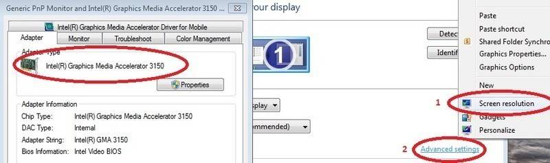

Thanks r4z0r84. I'll try this out. How do I know what onboard driver I have?
download GPU-Z
http://www.techpowerup.com/downloads/2173f/GPU-Z.0.6.5.exe
it will tell you exactly what graphics card you have in your computer
also shows a lot of helpful diagnostic information if your interested at a later date,
alternatively you can find out via right clicking on your desktop, selecting Screen resolution
clicking advanced settings(bottom right)
up the top it should show adaptor type, Intel/nvidia/amd
i have attached a picture to guide you for the manual way (that does not require GPU-Z)

If you are running windows XP, right click desktop, Properties, screen resolution tab, adaptor settings, and you should see the same as above, this is if my memory serves me correctly haha, either way updating your graphics drivers can't hurt but i am 99% sure this will fix your issues.
