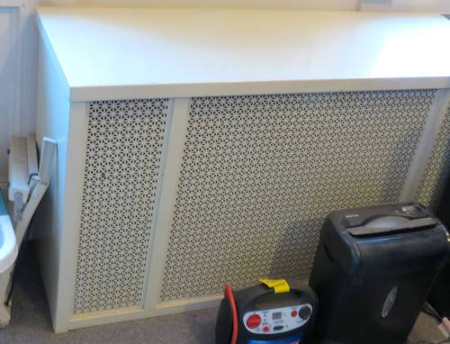

True, but in a live steam system they get DAMNED hot when the steam is flowing. There's no way you could keep your hand on one. Just touching them briefly is painful. The covers are perforated metal several inches away from the radiator and even the tops of these can get too hot too keep your hand on.
Yeah, I know; my sister's 100 year old apartment in Boston didn't have covers on them though. I'd guestimate they can be 130-150F, which is hotter than modern standards would allow.
