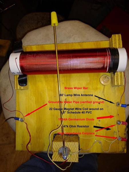

If anybody here has any experience with building a crystal radio, I would appreciate a response.
My grandson and I are doing radio projects. This involves basic crystal build using a coil, diode, and resistor. The system is grounded and uses an antenna with no external power and a high impedance earpiece for audio.
The radio works for a few seconds when left hooked to the ground and antenna, but then the sound fades.
Any ideas?

Thanks for the response. I am on the periphery of my technical expertise...trying to get my grandson interested in something other than video games. We built one of these very in very similar fashion and it worked (sort of). I'm trying to improve the design. In answer:

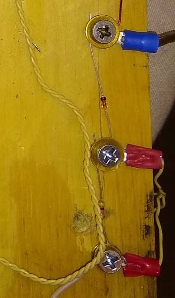

I have attached a photo. There are no capacitors. The earpiece is a high impedance unit, Philmore No. 748, sold to be used with the crystal set. I have a verified ground connection, 50' of lamp wire antenna, 47k Ohm resistor, and Germanium diode.

You have a resistor connected across the earpiece, which is good. You could check the resistor is making good contact. If you have a multimeter you can check for a resistance reading of about 47 kΩ between the earpiece screws. Try the multimeter leads round both ways as in one direction the diode and coil will short out the resistor and give a low reading. If you haven't got a multimeter just check the resistor leads are clean and are firmly gripped by the earpiece screws (but not so tightly that they pull the leads out of the resistor).
How did you verify the water pipe ground? Did you make your connection to the water pipe at a point where you can check there is continuous metal pipe between your connection and the ground? Metal water pipes can be joined to plastic pipes underground and hence offer poor Earth connections. Try pouring some water on the pipe where it enters the ground and see if that changes the behaviour. You could also try making your own Earth connection with a tent peg or by driving a couple of feet of copper water pipe (available from DIY stores) into some soil.

I am securely grounded to a cold water pipe. This is continuous copper, and I checked it by testing voltage to ground. I have a background in electrical work, but not in this area. I know that all my connections are secure, tested everything thoroughly.
I am learning this along with my grandson. We started off with this simple design, wish to expand to more advanced, but this one needs to work. Do you think I am OK with my antenna?

0 V to ground might just mean an open circuit rather than a good connection. Some plumbing connections, especially fast-fit ones, can act as insulators though this obviously won't be a problem with continuous copper pipe.
The 50' antenna wire sounds plausible. Whether it's adequate depends on how far away is your nearest radio station in the band the receiver is tuned for. Keep the antenna off the ground and reasonably straight. If you can't get it largely vertical, as suggested by berkeman, try swinging it round horizontally by up to 90° to see if you can pick up other stations.

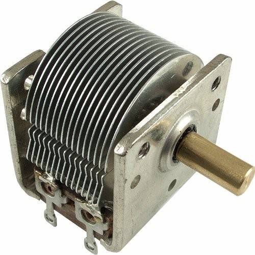

there should be a capacitor (variable) else you don't have a tuned circuit
a basic easiest circuit ...

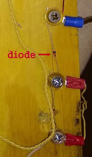

How many spots on the crystal have you tried with the whisker point? Have you tried cleaning the crystal surface and letting it dry before trying probe points?
The photo caption shows a 1N84A germanium diode (partially hidden by the brass wiper) so these aren't issues.
Oh, shoot, I misunderstood. Thanks for clarifying that. I saw "crystal radio", and made assumptions that was what the project was. What's a more accurate thread title -- just a simple unpowered AM radio receiver?

The fact that it works for a short time then fades shows it is at least tuned to a transmitter, the antenna (and likely Ground) is adequate, the crystal is functional, and the earpiece functions.
Since the earpiece is labeled as High Impedance, it is probably of piezoelectric construction (about the only type that works with a crystal radio!). Being piezoelectric, to the outside world the earpiece presents as a capacitor, which will charge up, acting as a filter cap, from the rectified receive signal. That is the purpose of the 47k resistor, to discharge the DC on the earpiece. Without the resistor, the earpiece charges to the peak voltage of the received signal and the diode (crystal) is biased off.
Possible causes:
  • Earpiece not connected correctly
  • Resistor faulty
  • Resistor not connected correctly
Conclusion: replace the resistor

Thanks, all. I did not expect such assistance.This is nothing more than a simple AM unpowered receiver unit if there was any question on it.
I think the earpiece is OK. I ordered a couple of extras and the problem seems to be be present with all of them. I have checked all the connections and am satisfied they are correct. I have not been able to receive a signal strong and long enough to identify what is coming thru the set. I am not happy with the antenna, but I figured it would work well enough to get something consistent and it has not so far. As far as the ground is concerned, I tested it with AC voltage to make sure. I show a full 120 VAC going to ground on the cold water pipe I am using. The pipe is copper all the way to the street, buried to the main a distance of 50', about 48" deep.

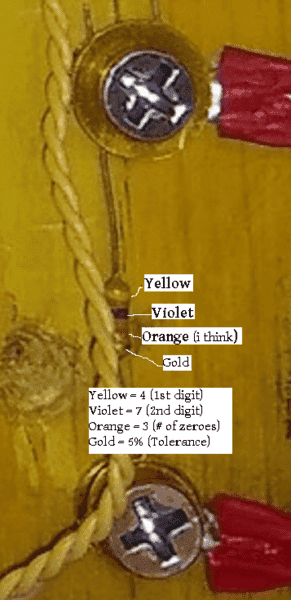

i can't quite make out the color code on your 47 KΩ resistor.
At 600% it looks like it could have a yellow multiplier and that'd be 470 K Ω
make sure it's yellow-violet-orange not yellow-violet-yellow.

It was sure bought and labeled 47k. Try this high res pic. I don't know the color bands.

Consider wrapping a/o soldering or otherwise securing the components. Wood screws into woodblock could loosen as you work the slider, etc.

I actually thought of that. I think the connections are secure. I have been over them. You can't tell from the photo, but the connections are caught between brass washers on the wire and components. The wiper bar connection is spring loaded.

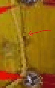

Yes, but brass is not a conductor. I have a set of brass tools for tuning sensitive circuits to avoid impedance changes from inserting tools. Not sure about the screws. Stores such as Fry's Electronics or other online sources sell inexpensive circuit boards with conducting wrap posts (apologies for my poor nomenclature) for DIY soldering projects.
That could explain a lot. Let me look at this again.
Brass contains copper and it will read continuity. Is it insufficient for these small value transmissions?

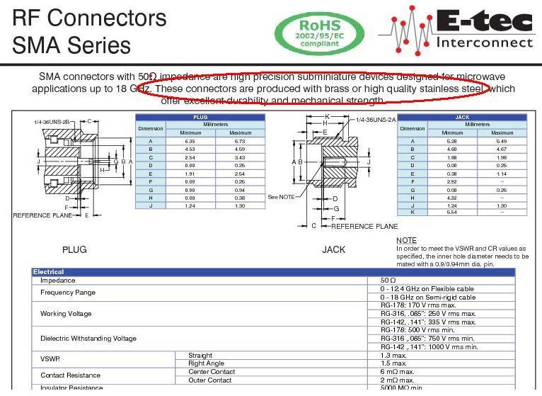

who-ever told you that ??
Yes it is it's a good conductor ... it's made from tin and copper, both good conductors, millions of RF connectors are made of brass
eg.
so my previous comment negates the reason for your use of brass as a tuning tool
It is used because it is non-ferrous/ferro-magnetic and that is why it has negliable effect on the tuningDave

Much better, THANKS !
Looks like you're okay
i'm still unsure of the third band but you can look to make sure it's orange.
