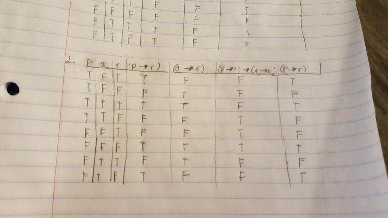

Kingyou123
98
The question I'm asking about is number two. Should've made it clearer.
N/A
My proof table, I'm not sure but it seems that PΞQ is not true.
Hi Kingyou:
Your calculation looks right to me.
Regards,
Buzz
A few hints:
  1. Set out your truth table methodically - this makes it easier for you to check and easier for a marker to give you partial marks
    Code:
    p q r
    T T T
    T T F
    T F T
    T F F
    F T T
    F T F
    F F T
    F F F
  2. Read the question carefully - why have you calculated p → r ?
  3. Learn the truth table for implies
    Code:
    a b | a→b
    T T | T
    T F | F
    F T | T
    F F | T

MrAnchovy said:
  1. Read the question carefully - why have you calculated p → r ?
To be clear, I meant why have you calculated p → r (incorrectly) in the first calculated column of the TT?
I assumed ## p \rightarrow -r ## together with the given premises and concluded r , so I showed by contradiction that ## p \rightarrow r ##. Unfortunately I don't know well the Latex for logic symbols to do
the actual derivation of ## p \rightarrow r## and ##p \rightarrow - r ##..
Oh this has got very confusing, my post #10 was intended to clarify my post #3 pointing out that the OP had misread the question which asks for (p → q) → (q → r) ≡ (p → r) and attempted to show a TT for (p → r) → (q → r) ≡ (p → r) instead.
As for your post #11 WWGD, note that the negation of ## (p \to q) \to (q \to r) \equiv (p \to r) ## is not ## (p \to q) \to (q \to r) \equiv (p \to \neg r) ## it is ##(p \to q) \to (q \to r) \neq (p \to r) ##

What is wrong with my work?
Look at what you have written at the top of your fourth and sixth columns and read the question again.
And then apply the truth table I showed you correctly.
The easiest way to do this is to create the truth table for the expression
## (p \to q) \to (q \to r) ##
Then look for two things. First, check to see if the truth value (for any fixed values of p and r) depends on q. If so, the equivalence cannot hold. If not, then check if the truth table for the above expression produces the same values for a fixed p and r as ## (p \to r) ##.
You have the wrong result for a ⇒ b . The only instance in which a ⇒ b is false, is the case of a is false and b is true.
