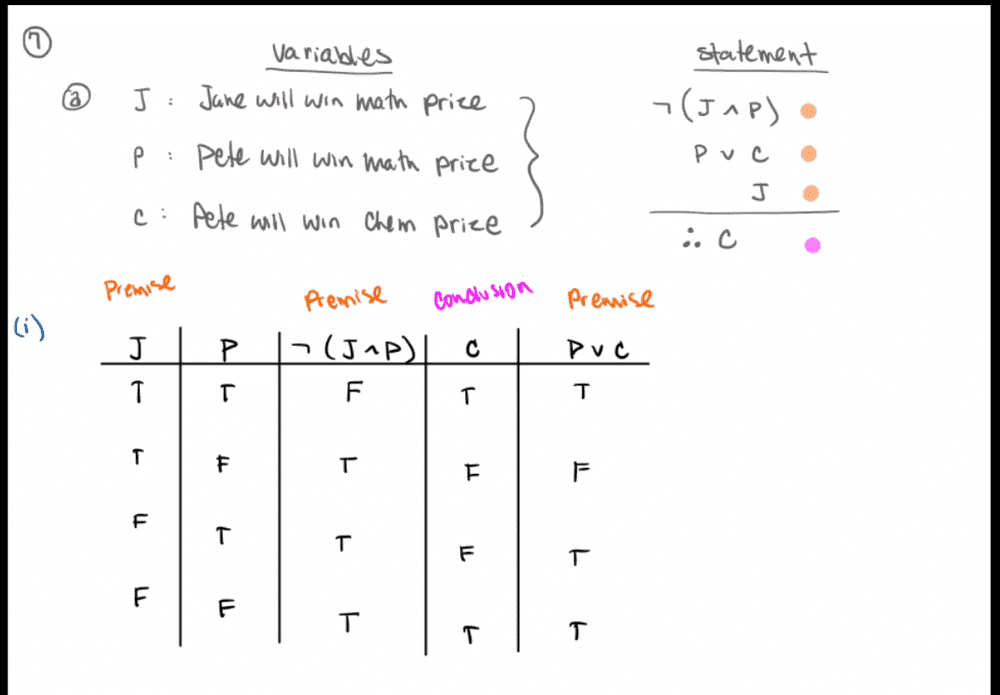

This isn't a homework problem, but I was going to post it in there as my question is similar to one that would be asked there. However there doesn't seem to be a logic section for it so I posted it here.
The question is to make a logic table to determine if the following statement is valid:
Jane and Pete won't both win the math prize.
Pete will win either the math prize or the chemistry prize.
Jane will with the math prize.
Therefore, Pete will win the chemistry prize.
I've attached an image of my truth table, but I don't think it's correct as in none of the cases are all three of my premises true.
You haven't considered all eight cases. There are three inputs: J, P and C so there are eight possibilities. There are four you haven't considered, and they include ##J\wedge \neg P\wedge C##.

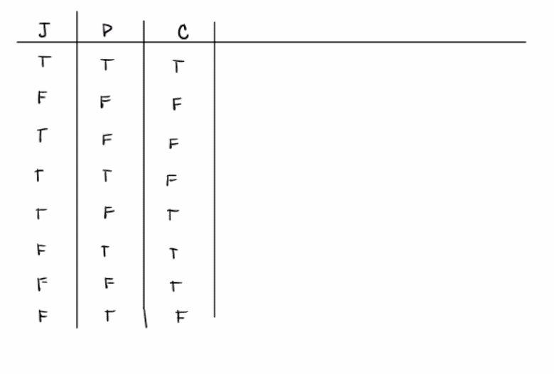

Excellent thank you. I feel like this covers them all, but what if there's something like A,B,C,D,E? Is there a way we can determine how many unique cases there will be?

There will always be ##2^n## rows in a full truth table when there are ##n## different inputs.
Often some can be quickly ruled out and on a pragmatic basis left out of the truth table, based on the axioms provided. For instance, in this case the axiom ##J## (Jane wins the maths prize) allows us to rule out all the cases where ##J## is false, thus narrowing our focus to a truth table with only four entries.

Ok thank you guys. It seems the most difficult part is what to put in the column headers as the premises and conclusions.
I think there are three types of columns: inputs, premises and derived results.
In this problem, there are three inputs: C, J, P.
There are three premises: the three statements in the OP, which you have labelled with orange dots in your picture.
Derived results will be expressions involving the inputs. There is at least one essential derived result column, which is the conclusion that is to be proved. In this case that is C, which may be confusing because it is also an input. We could double-label a column as both input and conclusion, but I think it makes it clearer to have separate columns for C as input and C as conclusion.
The other derived result columns, if any, are for parts of the conclusion. They can be helpful if the conclusion is a big, multi-part statement and it's easier to work out parts of it first and then combine them. We don't need those here because the conclusion statement is atomic.
Having set up the columns, my approach is to delete (eg rule a line through) each row in which any of the premises are false.
If there is one or more row remaining that means it is possible to satisfy the premises. If not then the theorem has been proved to be vacuously true.
Otherwise we proceed to delete any remaining rows in which the conclusion is false.
If any rows remain after that then the theorem is proven. If not it is disproven.
