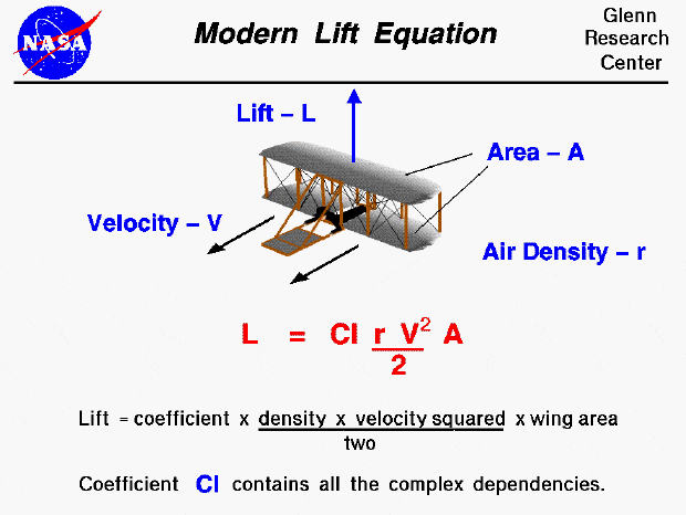

I went ahead and out of laziness, took the "Thin airfoil theory" route which isn't 100% accurate, but asserts that the [coefficient of lift = 2 times pi times the angle of attack (in radians)].
Easily enough I was able to calculate that, and use that in the lift equation found here, however, it posed a problem. When making changes to the speed (in straight and level flight, in game - at least using some specific plane-models), load factor increased due to the fact the lift is directly proportional to the speed of the aircraft (see above). Is this normal? I've basically balanced the weight and the surface area of the aircraft so that when flight is straight and level (and no excess thrust provided), lift / weight = 1, but from your description above, it sounds like coefficient / weight should be = 1 right?
No. As a general rule, the lift is proportional to the square of the airspeed. Lift is proportional to q= dynamic pressure.
Please, see:
https://wright.nasa.gov/airplane/lifteq.html
https://www.grc.nasa.gov/www/k-12/airplane/lifteq.html
