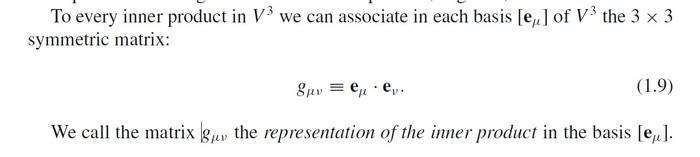

Hi all,
The basis vectors are defined as 1x3 matrices, how can the result be a 3x3 matrix?
How can the result of a dot product be a 3x3 matrix, I'm stumbled, how can I evaluate this?
A inner product returns a scalar, and now it returns a 3x3 matrix, please help.
Thanks.

You have 9 dot products.
You have a term ##g_{\mu\nu}## for all the possible combinations of ##\mu, \ \nu##. That's 3*3.
The 3*3 matrix is :
##\begin{pmatrix}
e_1\cdot e_1 & e_1\cdot e_2 & e_1\cdot e_3\\
e_2\cdot e_1 & e_2\cdot e_2 & e_2\cdot e_3\\
e_3\cdot e_1 & e_3\cdot e_2 & e_3\cdot e_3
\end{pmatrix}##

But in the book they define lower indices as the number of colums, so I thought it were two 1x3 matrices?
An inner product associates a pair of vectors with a scalar (and has a number of properties that I won't write down here).
So with a basis of 3 vectors, you can associate 3*3 inner products, and that gives you the matrix I posted above.
I don't know about the notation in your book, but in the image you posted it is clearly stated that ##e_1, e_2, e_3## form a basis, thus each of them is a vector. Their respective inner products is a perfectly well defined scalar.
I only watch the beginning of the video, but yes, the matrix representation of a inner product she is computing is the same concept as the one in your book. She uses a somewhat different notation, though.

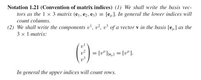

So suddenly the lower indices represent columns in the case of μ and rows in the case for ν? And it's just plain matrix multiplication.
First thing Samparlis did was define this in the book:
So when I saw eu and ev I thought two 1x3 matrices, since see notation above, which is not right, right?
So my error is, I don't understand the notations? Lower indices are not always columns?If he defines the upper indices as rows and columns lower indices why isn't itguv = eu . ev
instead of writing everything lower index

##e_1, e_2, e_3## are (basis) vectors. They are not 1*3 matrices. The 1*3 matrix is ##(e_1, e_2, e_3)##, the matrix consisting of the three vectors taken together.

He defines ##g_{\mu\nu}## as the inner product of the vectors ##e_\mu## and ##e_\nu##.
So what he meant is
e1
e2 times e1 e2 e3
e3
and ordinary matrix multiplication?
Waxterzz said:
So what he meant is
e1
e2 times e1 e2 e3
e3
You can represent it this way. Just keep in mind that ##e_1,e_2,e_3## are themselves vectors, not scalars. And that the "product" of two vectors is the inner product.
To come back on my question.
Part of the confusion arose, because I've forgotton or looked over the meaning of the ≡ character. They were referring to the elements of the matrix. Stupid of me, but it's clear now.
