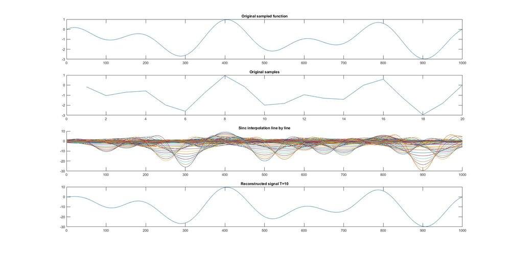

Hi Jason,
Thanks for the clarification. I included some working code below that illustrates what I was trying to accomplish.
My research project is formulating the Time Dependent Schrödinger Equation perturbation series in terms of recursive convolutions. I haven't found a resource for this, so I am exploring it on my own. To do so, I want to treat the potential V as a signal ##V(\omega)##. My analysis on paper results in a process that looks like this:
$$\int_{t_0}^{t'} dt_1 e^{i \omega_a t_1} \sum_b V_{ab}(t) e^{-i\omega_b t_1}$$
which I manipulate into the form
$$sinc(\omega (t'-t_0)/2) \ast \sum_b V_{ab} \delta(\omega - \omega_b)$$
That's not exactly it, I am still working it out, but the end result seems to be a recursive convolution between the sinc function over ##\omega## at varying widths ##(t'-t_0)##. So in the code below I start with a continuous function (in ##\omega## I think), I sample it periodically (in ##\omega##), and then I reconstruct it by convolving with sinc functions of gradually decreasing width.
The bottom graph is an excellent reproduction of the top graph.
Matlab:
close all;
clear all;
res = 1000;
figure('units','normalized','outerposition',[0 0 1 1], 'NumberTitle', 'off', 'Name', 'Scattering');
x = linspace(0,1,1000);
%highest frequency of signal = 5
sampledFunc = cos(5*2*pi*x) + sin(3*2*pi*x) - 1;
N = 20;
%Capture samples
for n = 1:N
    % Collect N samples across entire plot (one period)
    samples(n) = sampledFunc(round((n*res/N)));
end
%Plot samples
subplot(4,1,1);
plot( sampledFunc );
title('Original sampled function');
subplot(4,1,2);
plot( samples );
title('Original samples');
for T = 1:10
    sincInterp(samples, T, res);
    pause(.5);
end%% Function definition
function [o1] = sincInterp(samples, T, res)
w = linspace(0, 1, res);
result = zeros(size(w));
%I want all samples to fit evenly on the graph
Nsamp = length(samples)
step = res/Nsamp;
for b = 1:length(samples)
    %Turn this into a function of t
    %Each Vbk(b) is the b-th coefficient, so it is associated with a cosine
    %wave of frequency b.
    %Each cosine is layered on to the previous.
    shift =b*step/res;
    shiftedW = w-shift;
    newSinc = samples(b).*sin(T*2*pi*shiftedW+1E-8)./(2*pi*shiftedW + 1E-8);
    result = result + newSinc;
    ax3 = subplot(4,1,3);
    hold(ax3,'on');
    plot( newSinc );
    title('Sinc interpolation line by line');
end
    hold(ax3,'off');
    ax4 = subplot(4,1,4);
    hold(ax4,'off');
    plot( result );
    title_message = strcat('Reconstructed signal T=', num2str(T));
    title(title_message);
o1 = result;
end
