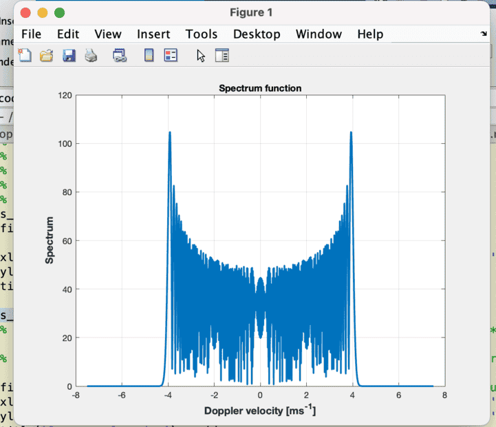

I want to know the frequency domain spectrum of an exponential which is modulated with a sine function that is changing with time.
The time-domain form is,
[tex]s(t) = e^{j \frac{4\pi}{\lambda} \mu \frac{\sin(\Omega t)}{\Omega}}[/tex]
Here, [itex]\mu[/itex], [itex]\Omega[/itex] and [itex]\lambda[/itex] are constants.
A quick implementation in MATLAB gives me the following in the frequency/velocity domain.
MATLAB plot titled Spectrum function: magnitude spectrum against Doppler velocity in m/s from -8 to 8, with two sharp peaks near ±4 m/s reaching about 105 and a dense oscillatory plateau between them.

I want to know what this function should look like in the spectrum domain analytically.
I haven't looked at your Matlab code, but the way to get an analytical expression is to use the generating function for Bessel functions
e^{\frac{1}{2} z ( x - x^{-1})} = \sum_{n=-\infty}^\infty x^n J_n(z)
set ##x=e^{j\Omega t}## and ##z = 4\pi\mu/\lambda\Omega## to get
e^{j \frac{4\pi\mu}{\lambda\Omega} \sin(\Omega t)} = \sum_{n=-\infty}^\infty e^{j n\Omega t} J_n\left(\frac{4\pi\mu}{\lambda\Omega}\right)
You can analytically work out the DFT of ##e^{j n \Omega t}## for your given sampling. I expect it will be some kind of geometric series.
jason
Nice Bessel function property. However, when finding the DFT I see that it is not just a geometric progression, as ##n## appears in the Bessel function order. I am writing the steps here. Correct me if I am wrong.
S(v) = \sum_{n=-\infty}^{+\infty} e^{jn\Omega t} J_{n}\Big(\frac{4\pi \mu}{\lambda \Omega}\Big) e^{-j \frac{4\pi}{\lambda} n v t}
$$\implies$$
S(v) = \sum_{n=-\infty}^{+\infty} e^{jnt(\Omega - \frac{4\pi\mu}{\lambda})} J_{n}\Big(\frac{4\pi\mu}{\lambda \Omega}\Big)
My variable for DFT is ##v##.
Or, am I stupid enough to not see something in the above formulation? :confused:
The equation I gave is a continuous waveform. You first need to sample it at discrete times, then for each frequency component of the DFT you need to compute a sum. If the sample period is ##T## and we collect ##L## samples, then the ##\ell^{th}## sample of the discrete-time signal is
$$ X(\ell) = e^{j \frac{4\pi\mu}{\lambda\Omega} \sin(\Omega (\ell-1) T)} = \sum_{n=-\infty}^\infty e^{j n\Omega (\ell-1) T} J_n\left(\frac{4\pi\mu}{\lambda\Omega}\right)$$
where ##\ell## goes from ##1## to ##L##, just like Matlab vectors. This is the signal you are taking the FFT of.
I hope you know that the DFT (and hence the FFT) assumes that this signal consisting of ##L## samples is one period of a periodic signal. Assuming this is what you want, the DFT in Matlab is then defined as
$$Y(k) = \sum_{\ell=1}^L X(\ell) e^{-j\frac{2 \pi}{L}(\ell-1)(k-1) } $$
where ##k## goes from ##1## to ##L##. So the DFT is
$$Y(k) = \sum_{n=-\infty}^\infty J_n\left(\frac{4\pi\mu}{\lambda\Omega}\right) \sum_{\ell=1}^L e^{-j\frac{2 \pi}{L}(\ell-1)(k-1) } e^{j n\Omega (\ell-1) T} $$
The inner sum is a geometric series. Since ##J_n(z)## decreases fairly quickly once ##|n| > |z|## I expect this should be a practical formula.
jason

Wow! now it is clear for me. Sometimes I get confused even if I know how to proceed. Thanks a lot. I will try this soon.
