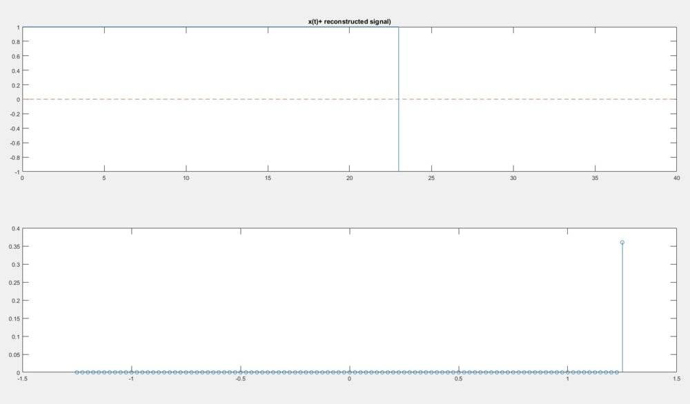

I want to determine by using matlab the Fourier Series Complex Coefficients of the signal x(t), based on the below formula and to plot the amplitude spectre. Also, I want to rebuild the initial signal using the determined Fourier Coefficients, and I want to plot on the same graph the initial signal and the rebuilt one so that I can compare them. Unfortunately, haven't got the expected results.
x(t)=1/P*[Σ][/k][/∞]=-∞[X][/k]*[e][/jkw0t] with w0=2π/P;
[X][/k]=[∫][/P] x(t)*[e][/-jkw0t] dt for k coefficients;
[x][/^](t)=1/P*(X0+2*[Σ][/N][/k=1] [X][/k]*[e][/jkw0t] ); [X][/-k]=[X][/k][/*]; for reconstruction of the signal.

My result:

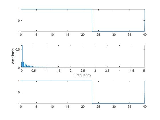

The following plots demonstrate the corresponding code shown below. The plots are original wave, amplitudes of different frequencies, and reconstructed wave respectively.

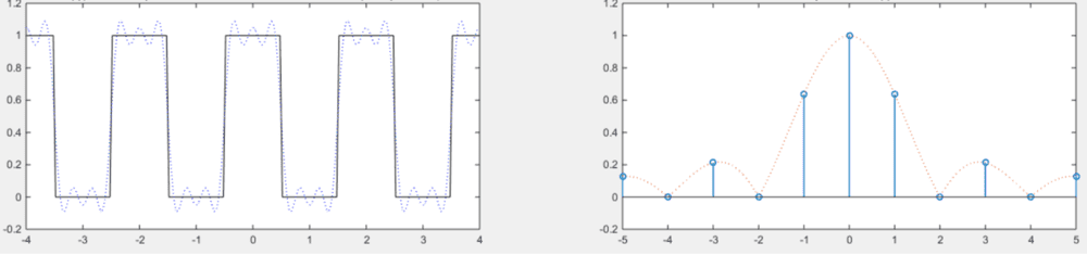

Hi,LeafNinja ! Thank you for the response! I'm trying to reconstruct the signal but using only a limited number of coefficients. In my case N = 50.
Should obtain something like the example in the photo.
Looking at the plot on the right, I cannot tell what N is but it appears that -N<=n<=N but only -5<=n<=5 is shown.
You can find the nth coefficient using the discrete Fourier transform using the equation below and then taking the absolute value. ##a_{n} = \sum_{k = -N}^{N} X(k) e^{-\frac{ 2j\pi nk}{2N}} ##
where -N<=k<=N corresponds to -T/2<t<T/2 and the period T appears to be 2 in this case, looking at the plot on the left.
*This is a slight variation to the discrete Fourier series formula shown above
Then, by taking the inverse discrete Fourier transform, you can reconstruct the signal. Remember that because you are using positive and negative n, the coefficients are conjugates so you only need either positive or negative.
