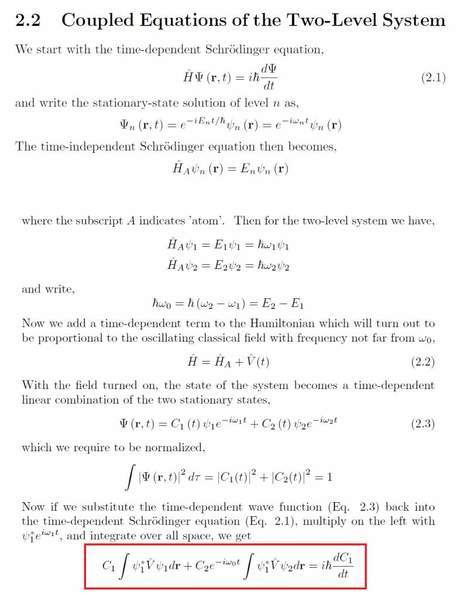

Hello guys,
in the attached file, I can't understand how the guy arrived to the equation in the red rectangle.
My problem is: how could there not be dC2/dt term. Why only dC1/dt term?
ψ contains both C1 and C2, and when the derivative is applied, both have to be influenced, and both are functions of time. Why does C2 disappear?
Could someone please explain how this last step is exactly taken?
Thank you for any efforts.
  • Printed page from section 2.2 'Coupled Equations of the Two-Level System', showing Schrodinger equations, two-level Hamiltonian relations and a boxed final equation C1 integral of psi1* V psi1 plus C2 e^(-i omega0 t) integral of psi1* V psi2 equals ih dC1/dt.
Because it had been something like (dC1/dt) ψ1 + (dC2/dt) ψ2. But then he says "multiply by ψ1* and integrate over all space." Well, ∫ψ1*ψ1 dx = 1 so you don't see it explicitly in the result, just dC1/dt is left in the first term. But ∫ψ1*ψ2 dx = 0, by orthogonality, so the dC2/dt term drops out completely.
