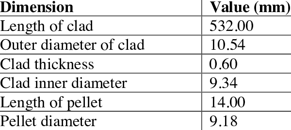

I found this in 10 seconds with this search on Google Images:
https://www.google.com/search?q=PWR+fuel+dimensions
These dimensions are more representative of CANDU (532 mm or ~0.5 m indicates CANDU fuel design), which are certainly PWRs, but not LWRs. LWR (PWRs) typically have 12 ft (3.66 mm) fuel stacks, although some have longer 12.5 ft (3.81 m) or 14 ft (4.27 m) stack lengths.
