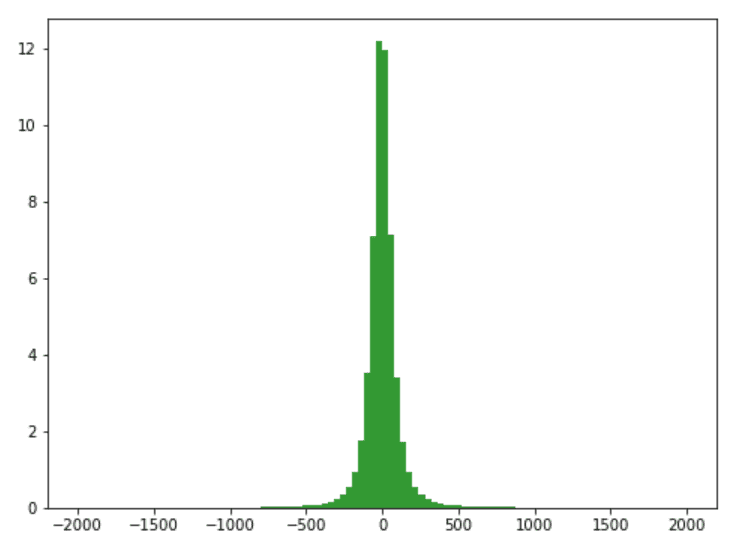

Here is the histogram you asked for. I am just not firm with the application of the poisson distribution since everyone says it kind of always applies in counting experiments but I still don't know why that is.
A second thing that I am unsure about is if the error from the MC ist poissonian I should take sqrt(N) as the errors for each bin but I have 10.000 events and in every event another number flows into one of the bins. So if I have 100 events flowing into one bin and the value of these events sum up to two the error won't be 10. So probably I should interpret the specific values as a weight which comlicates things.

Ok, seeing that I feel more confident saying Poisson is what you want.
I could give you my spiel about why the Poisson distribution is appropriate, but there are probably 1000's of folks online that have already given good explanations and put more time in than I would have. This video might be a good place to start.
The technical reason for why the poisson distribution is appropriate is that it is the limit of the binomial distribution as the number of trials goes to infinity and the mean number of successes is kept finite. Whenever you skim a few outcomes from a much larger pot of outcomes (raindrops on a roof, electrons over a threshold, photon shot noise, or points in a histogram bin), the Poisson distribution is what you need. If what you're asking is how you assign error bars to your histogram plot, take the square root of the number of points in each bin (that's the signature feature of the PD).
You are counting phase space points. If they are selected randomly then Poisson-like uncertainties should be right (your events have weights, so it's not a simple sqrt(N)). If they come from some grid then the uncertainty will be smaller. If computing power allows you can repeat the analysis with different grid patterns and compare the results to estimate the uncertainty.
Just from looking at your plot, bin-by-bin variations are probably very small.
