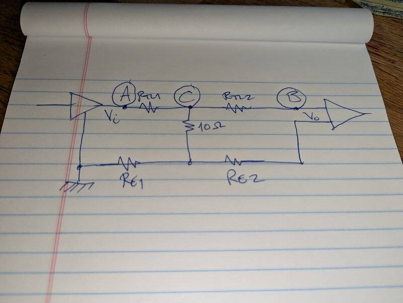

Um, give me a couple minutes to make a crude drawing...
(unless somebody else beats me to it!) :wink:
Something like this (can you see how the problem is underspecified?)...

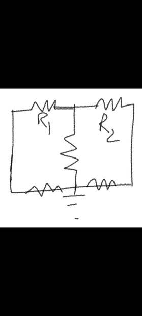

Okay. Would that mean R1/R2= ratio of resistance in the ground since area of cross section is same so length is the only parameter which is same as well..
  • Hand-drawn circuit schematic with two resistors labelled R1 and R2 in a rectangular network, a central resistor between them, and a ground symbol at the bottom.
Yes. You can leave the Earth symbol out of the diagram. The Earth is fully represented by the extra "wires".

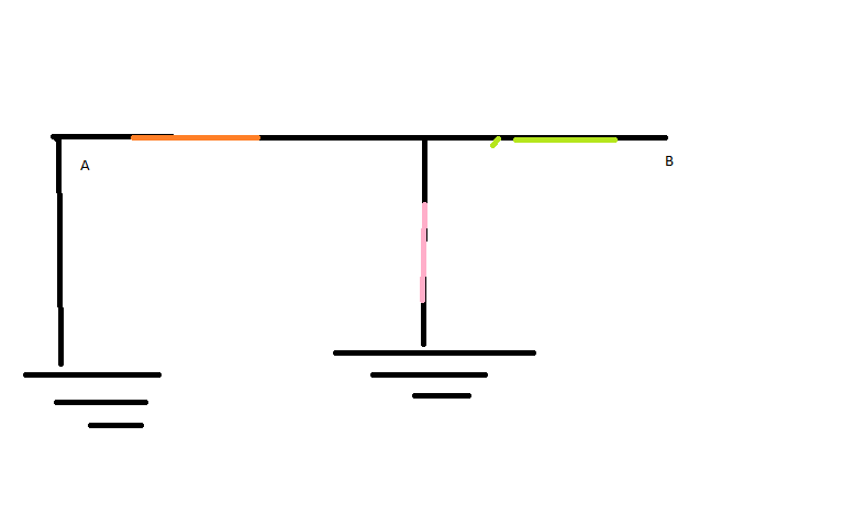

What i meant is even without applying the voltage there's already a potential difference between the terminal A and the earth no? So current would have flown without the additational battery being there..?
Circuit schematic of a horizontal wire from A to B with a vertical branch to earth at the left (labelled A) and a second earth branch below the middle, with an orange segment on the top wire and a pink segment on the vertical branch, and a green segment near B.
Some questions:
i)There was a current in the circuit AB before there was a fault. As soon as there was a fault the current passing through AB flowed down to the earth at C to equalize the potential difference.. my question is did all the current coming in flow down the earth? If so why? Why is it not going to B like it did before?
ii) How did you decide on the resistors in the cable (red and green)? What part of the question hinted at that? Why cant there be no resistors ( red and green)? Why can it not be an ideal underground cable?
iii) What is the significance of applying a voltage between earth and terminal A? If they connected a cable directly to earth current coming in through A would still flow to earth since there's an already existing potential difference..
iv) Why does the current flow back up to C? Ater connecting the cable didnt the potnetial at C and earth became equal?
v) After coming out of C why would the current not flow through B ? Is it because its an open circuit?

When there is no signal being sent and no test technicians putting test voltages in, there is no potential difference anywhere in the circuit.
When I first looked at this problem, I thought it was about wave dynamics and reflections/distortions caused to a dynamic signal 😅
Ground has always been a very confusing concept for me. To now have current flowing through two different grounds is pretty antithetical to the entire idea ^^.
So, as Berkeman and Haruspex have done, I wouldn't draw in "ground" anywhere.
The earth is just another cable lying parallel to the telegraph line in this exercise.
Consider the two scenarios:
(1) The technician at A is applying a voltage, B is measuring.
Think about it, if B is measuring voltage, then there is no current flowing from the line to ground at B. No current flows through the voltage measurement device.
Plus, there isn't any parallel path or load connected at B; the ends are just open.
Consequently, there can't be any current in the line segment leading from the fault to B or in the "earth segment" between the fault and B.
No current, no voltage drop.
So the voltage B's measuring is actually the voltage drop across our 10 ## \Omega ## fault at C.
(2) When B is applying a voltage and A is measuring, likewise, they just end up measuring the voltage drop across the fault at C.
If you feel like that already helped, go think some more on the problem. In case it didn't: when measuring the voltage drop across the fault, it's like a voltage divider. It's a simple circuit now with the same current flowing through everything.
The fraction of the total voltage drop across the fault is the same as the fraction of the total resistance.
