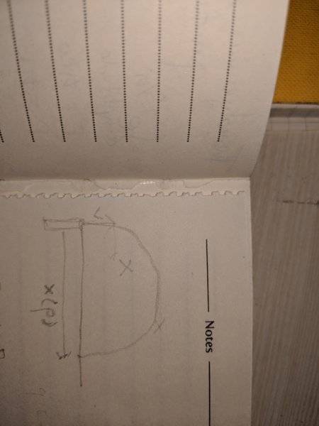

Consider an electron in a magnetic field. If the velocity is in the page, and the magnetic field is out of the page, then the electron will move in a circle whose radius depends on its momentum. So when it falls on the plate, we are essentially measuring the radius, and so we know what momentum is there. How does this fit with the uncertainty principle?

So you have an electron gun emitting electrons to the right, which travel clockwise until they hit a plate?
That's easy. Your gun has a finite size, so you do not know either the exact launch position or launch momentum (including direction!) of the electron. So you do not know the radius exactly. Narrowing the gun will increase the uncertainty about launch direction (it's a diffraction effect). Widening it decreases the momentum uncertainty (less significant diffraction) but increases your position uncertainty. Either way you have uncertainty about the radius and hence your momentum measure.
Perhaps the OP is using a special/different orientation but this experiment should result in cycloidal electron rotation. The attached diagram which appears similar to your picture demonstrates the distinction.
