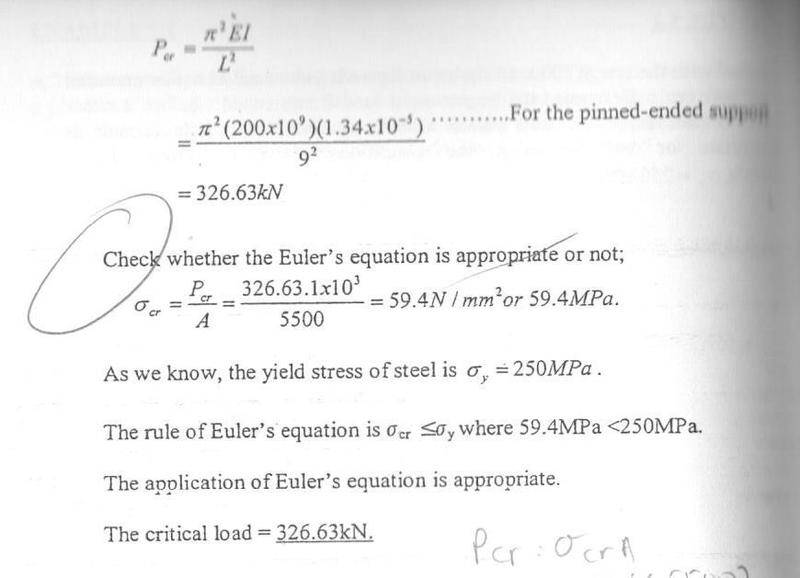

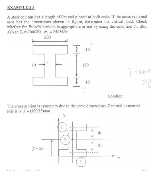

in the 3rd photo , i m having problem finding the critical load
to find the critical load , we should use the maximum stress multiply by the area which is 5500(250MPa) , am i right ? why the author used 59.4MPa(5500) ? is it wrong ?
  • Textbook page showing Example 5.3: a steel column cross-section with dimensions 200 wide, 150 web height and 10 flange thicknesses, plus a centroid diagram labelled ȳ = 85 with regions 1, 2 and 3 and distances d1 and d2.

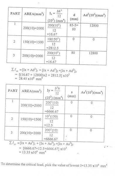

  • Handwritten worked table of section properties for three parts, with area, Ix, Ad² and Iy columns, followed by sums giving Ixx = 28.45 x10³ mm⁴ and Iyy = 13.35 x10⁶ mm⁴.

  • Handwritten-style worked solution of Euler buckling for a pinned-ended column: Pcr = pi^2 EI / L^2 gives 326.63 kN, then stress check sigma_cr = Pcr/A = 59.4 MPa against yield stress 250 MPa, and the critical load is stated as 326.63 kN, with Pcr = sigma_cr A written beside it.
