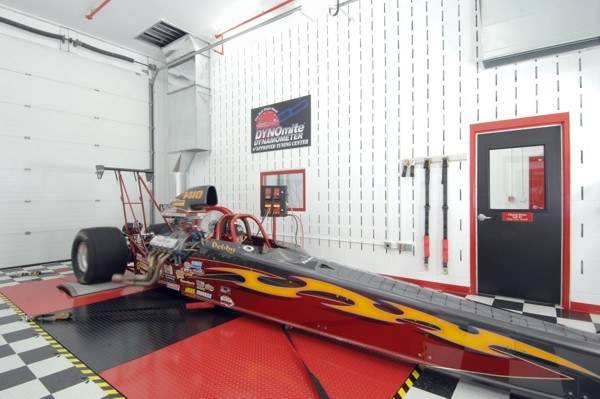

Great info guys. I am still trying ti figure out what *flavor* of dyno they would use for a dragster? It seems that I am finding some info that conflicts (mostly because I don't understand every application).
There are *inertial* dynos that cannot measure torque directly and there are brake dynos which can. Since a dragster cannot really be kept at a steady state load (else the engine will burn), it wold see that the inertial is better for this application seeing as *brake* dynos need to be run at steady state.

What kind of dragster are you thinking about? Not sure I have ever seen a commercial dyno that can handle much over 1000 hp, but someone correct me if I am wrong. For top fuel dragsters I always seem to hear "estimated hp" since there are not dynos that can handle them.
When I have seen brake dynos run, they can certainly do "dyno pulls" by varying the load on the rollers during acceleration. I have run a water brake dyno, its load varied with RPM due to the "absorber" design and a variable valve.

Are you talking about this:
Dyno-mite website said:
1,200 to 2,500+ Hp** Pro chassis kits include a FWD/RWD (optional AWD upgrade shown below) tube-steel frame with 24", 30", 44", or 60" diameter medium-inertia rolls, bolt-on diamond-tread deck plating, floor anchors, wheel chocks, vehicle tie downs, water or eddy-current absorber(s) with step-up drive, electronic torque transducer, DYNOmite 28-channel data-acquisition computer, inductive RPM pick-up, DYNO-MAX “Pro” software, printer, Windows-7® equipped Dell™ laptop, mobile computer stand, Electronic Auto-Load Control, Weather-Station Kit, AFR Module, 42" high-volume cooling fan, hoses, engine-temperature thermistor, and full-function data harness.
