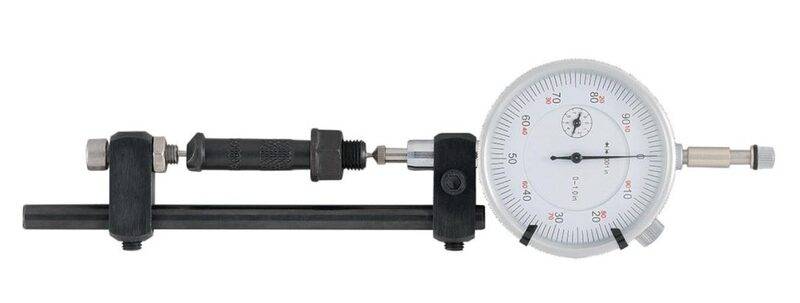

If you really want to know for sure, for your actual parts, you can test it by measuring the bolt stretch which is the true end effect of preload.
Take your bolt and nut (or one of similar material and diameter), apply the dry torque, and measure the bolt length. Repeat the process by lubricating the part and torque it until you reach the exact same bolt length. This new torque is the torque required for that particular bolt, nut, and lubricant.
True.
If you want to calculate the required torque, then there are several things that will need to be known.
1, 2. Friction coefficient between the threads, dry and lubricated.
3, 4. Friction coefficient between the nut, or screw head, turning against the workpiece, dry and lubricated.
5. Thread pitch, which determines torque required on the helical thread, to stretch the shank.

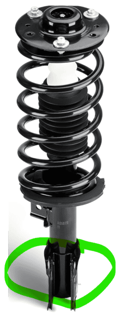

Would I have to to take this measurement while installed in the work piece though? Say for example McPherson strut assemblies. There are two brackets towards the bottom of the assembly. The knuckle goes in-between the brackets. A bolt goes in one side and the nut on the other to fasten the two together. Would I need to take my measurements with this measuring tool once completely assembled?
Or is it ok for me to take this measurement by just using the previous method by just tightening down the nut and bolt with nothing in-between?
My gut instinct tells me that the metal brackets on the McPherson assembly and the knuckle would provide some extra resistance to clamping down on it. But I don't that would necessarily matter?

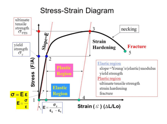

Of course, the closer you are to the original setup, the better it is. If you read the link in my previous post, even setting the same torque on two similar bolts, mounted in the same manner, may not give the same elongation. Still, what matters is that all bolts have stretched by the same amount (ideally in percentage of original length), not that they have the same torque.
The torque results in an axial force that will give the desired preload and the corresponding elongation. The relationship between the two is only a matter of radius and friction as said in post #3, not what they are squeezing together. Although having a similar final thickness will be better. (Elongation relative to original length is better than absolute length difference.)
This is why bolt manufacturers can provide a recommended torque value for their bolts, no matter how you intend to use them.
The elongation you measured should represent the strain just before the yield point in a stress-strain diagram; keeping it in the elastic region. (Although, some one-time-use bolts go slightly above, being plastically deformed, hence the reason why they have to be thrown away and replaced when disassembled.) The axial force ##F## for the corresponding stress would be the one used to calculate the torque required.

YoshiMoshi said:
So how exactly do bolt manufacturers specify a recommended torque when they don't know the desired clamp load for the joint?
They know what any bolt can withstand, before it suffers from plastic deformation. If you do not need most of that torque and clamping force, you are using a bolt that is too heavy and expensive for that job.

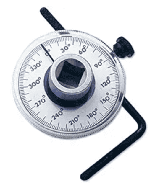

So I'm wondering if using the "angle method" and eyeballing the marks so that they line up is necessarily better than simply taking 10 % or 20 % off the torque specification? Say for example the eyeball angle method puts me off about 5 degrees. How much would being off by 1 degree effect the clamp load? I'm not sure if this can be determined, or if there are to many variables to know?
I'm also wondering, if it would be better to use an angle torque wrench instead of eyeballing it? This would require me to know the angle to fasten the fastener to specification ahead of time. Is there a way to calculate what the desired angle is based on the type of the bolt I'm using, the ideal torque specification from the manufacturer and so on? This might also be to complicated to calculate or to many unknown variables.

Another option would be a modified turn of nut method using a torque angle adapter.
Essentially this method:
1) Get bolt "snug tight" and mark the bolt in some way so you can return to this starting position.
2) Using a torque wrench with angle adapter, torque bolt to manufacture specified torque value.
3) Write angle down that measured while applying specified torque value.
4) Clean up the threads with a thread chaser, apply anti-seize of your choice.
5) Reassemble the joint getting bolt back to the "snug tight" position and line up the original mark from Step 1.
6) Continue to tighten the bolt to the measured angle from Step 3, using a ratchet with the angle adapter
This would ensure the same amount of bolt tension regardless of the lubricant used? I guess if you wanted to get really fancy, you could measure how many times you go past 360 + anything left over from completely unassembled with the bolt completely out of the nut, to fully assembled to the specified torque value. Then you don't have to worry about the definition of "snug tight" or being off by a few degrees from your marking. Another alternative might be to torque it some predefined low value like 10 ft lb or similar as a starting point.
Thoughts on this method?
