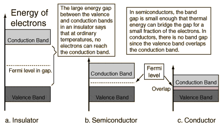

Hello everyone, I have finished high school not long ago, and haven't start my uni. So I take this time to read some physics. I have no one teachs me, the only book I have is 'Giancoli's PHYSICS'. Its a good book (discriptive but not mathematical, which suits me as I haven't done much sophisticate math).
Here is my question, are energy bands for every atoms in a solid (every single atom have energy band). Or the whole solid posses energy band (with each atom still have discrete energy level)? Or should I say the solid posses energy band with atom indistinguishable?
I have searched for a while, but cannot have a clear answer
Thank you for any help
Energy bands are a property of the whole solid object. While the individual states within these bands can be local (valence band), the "band" comes from the fact that you have a large amount of atoms in the material.
Yeah, energy bands are a property of the solid. I've found images like this one helpful:
http://www4.nau.edu/meteorite/Meteorite/Images/Band.jpg
When you bring together a bunch of atoms to form a material, you suddenly have a bunch of similar energy levels from different atoms all overlapping. The energy levels don't like to sit directly on top of each other, so they kind of shift around, resulting in a bunch of very closely spaced energy levels, or bands.

Thank you very much. I think I may get it.

A useful way to visualize the difference between conductors, insulators and semiconductors is to plot the available energies for electrons in the materials. Instead of having discrete energies as in the case of free atoms, the available energy states form bands.
