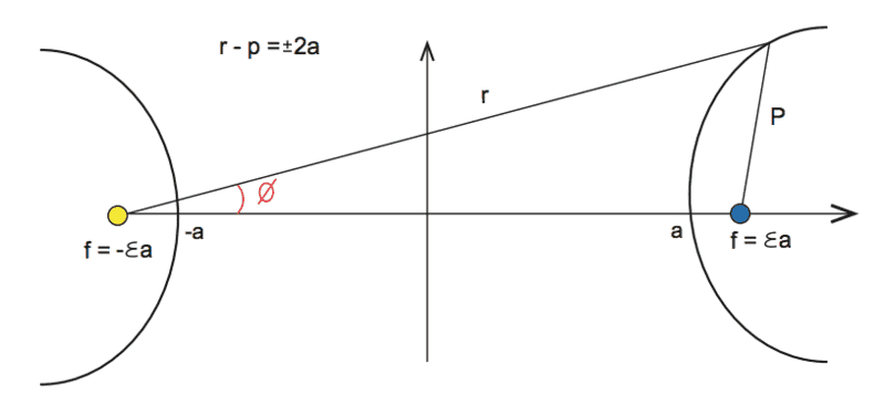

I'm rather confused as to where the orbited body is placed, and where the orbiting trajectory lies in this figure.
Is it right for me to say that if I placed say, the Earth on the left hand focus, a comet with a hyperbolic trajectory will travel a path defined by the equation ##r - P = -2a##?
Thanks in advance.

Looks right.

Hi, thanks for clearing that up!
Edit: Is r-P = 2a also a valid hyperbolic orbit?

Not if the sun is at the negative focus.

But if I do want to use r - P = 2a, and place my planet on the right hand focus, wouldn't I need to redefine r to originate from the right focus and P from the left? This gives r - P = -2a again.

It depends how you are defining r and P.
If you define r as distance from the left focus and P that from the right focus then for the gravitational source at the left focus it is r-P=-2a; for the gravitational source at the right focus it's r-P=2a.
But if you define r as distance from gravitational source and P as distance from the other focus then it is r-P=-2a whichever side the source is.

Thanks!
