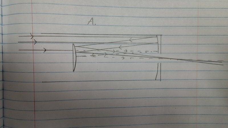

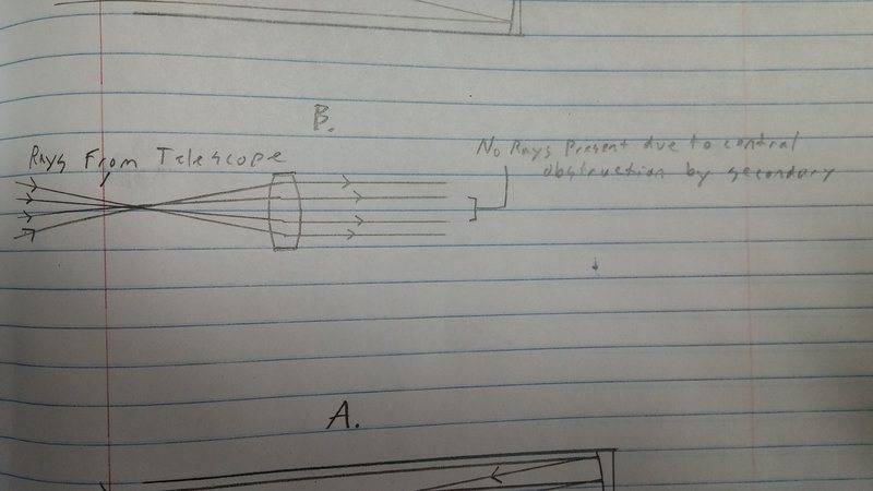

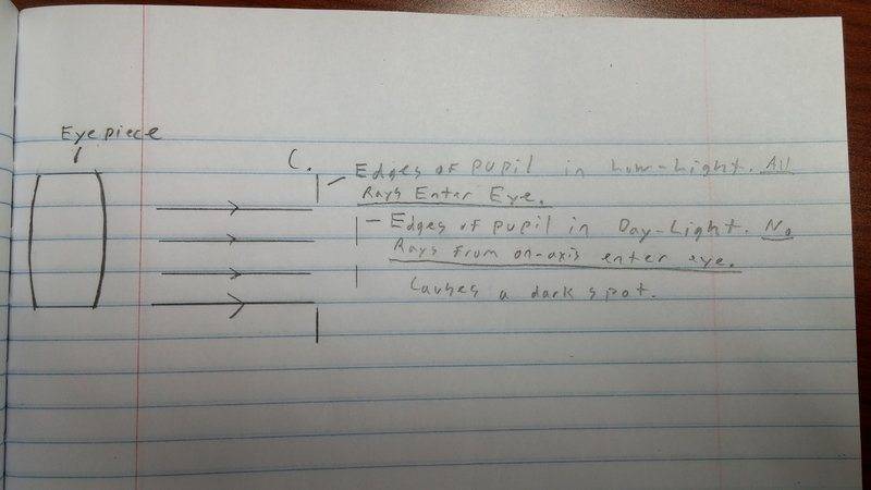

Here's some (poorly done) raytraces I made real quick by hand. Hopefully the forum doesn't bug out and eat them. And hopefully you can read them. None of this is drawn to scale.
A. Three on-axis rays coming into the telescope. The dashed line represents the path the blocked ray would have taken.
B. Rays entering and exiting eyepiece. Note that the dashed ray from earlier would exit the eyepiece closer to the axis than the other rays.
C. Rays after leaving the eyepiece and entering the eye. The dark-adapted eye accepts all the rays while the day-adapted eye rejects all the rays because of the size of the pupil.
Thanks a lot chaps. I knew PF would sort me out on this one. That dark region really does look like an 'obstruction' that you can avoid by moving the head a bit.Pupil / teacher jokes: AAArrrrgh! o_O

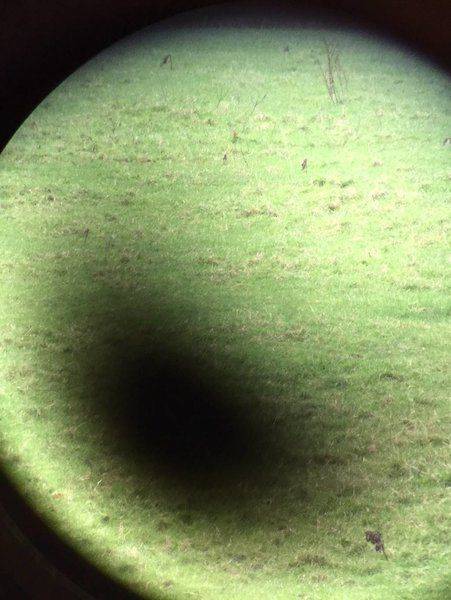

What you are describing sounds like kidney beaning, an issue common with wide field eyepieces. You can compensate by keeping your eye centered on the optical axis of the EP or backing away slightly from the eyepiece. It is especially noticeable when your pupil is not fully dilated - e.g., in daylight.
I looked at a number of links which discuss kidney beaning and I am not sure it that's what I have been seeing. Strangely, I could only find one image from a google search. Afair, what I have seen is not the same as the picture below.
