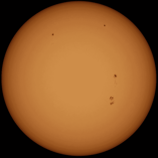

I observed a significant difference in details in a digitally magnified prime focus image compared to an optically magnified eyepiece image, for the same objective lens. Why?
I hope this is the right place to ask this.
I was clicking the Sun a few days ago with my beginner scope and a DSLR. The scope is a 60mm aperture f/12 refractor and the DSLR is a Canon SL3 (APS-C 6000x4000). First I used a 20mm eyepiece (35x) to view the sun, saw it in all its glory, the sunspots and the region around the spots that appear like hair or filaments (not sure what exactly they are called). Then I shot some images with my DSLR at prime focus. I realized that the apparent size of the Sun's disc in the image was smaller at prime focus which is because the eyepiece provided magnification. But to my eye viewing both the eyepiece image and the image on the DSLR LCD screen, the difference was not too much, maybe the eyepiece image was 1.5 - 1.75x times the image on the DSLR screen.
But what I did not expect was the loss in detail. The eyepiece image was much more detailed and sharp compared to the prime focus image recorded on the sensor. I could see the spots, but those hair-like / filament-ish outer regions of the spots now look like the sunspots itself. Unfortunately I cannot 'show' how I 'saw' through the eyepiece. I don't have an eyepiece projection mechanism set up.
Does the amount of detail in the image depend on the eyepiece magnification or is it only a function of aperture and exposure? If I understand correctly, the objective lens sets the resolution and resolution sets the amount of useful magnification. But the details / information is still present in the primary image? So I do not understand why the same primary image, when magnified optically with an eyepiece yields more details but when magnified digitally has significantly less details.
I have a few explanations to my observation:
  1. I was not clicking RAW. Can JPEG compression remove so much detail?
  2. Since the prime focus image is smaller, it was harder to focus to a crisp as compared to eyepiece, where I would focus until I saw those details around the sunspots.
  3. The prime focus image is not magnified enough to bring out the details (The DSLR sensor pixels are not 'seeing' resolved details)
  4. All of the above to certain degrees.
In the case that reason #3 is the best explanation, does that mean that the amount of details in the image is always limited by the objective lens and sensor pixel density when doing prime focus (because I am stuck with no optical magnification to bring out details)?
Thanks for any advice / help!
Edit 1:
A fellow astrophotographer online told me that single exposures are prone to atmospheric (seeing) disturbance and absence of tracking causes motion blur that smears out the details while viewing live with the eyes let's the brain do some filtering and we see a persistent detail which cannot be caught in an exposure (like lucky imaging). This makes sense to me, but I still think I saw a significant difference in details and would appreciate if I get your opinions on my points. Thanks.
Edit 2:
After fiddling with the settings and options in AutoStakkert!3, I managed to get a better picture after stacking ~300 frames from a recorded MP4 video (image attached). This is the best image I have so far! But it is still not as detailed as the live eyepiece view.

All of the above. What are you using as a solar filter?
Mylar white light solar filter that goes on the aperture.
If you think its all of them (including the reason given in the edit), do you have a stronger bias for anyone or two of them? (Because I could try working on them).
The mylar white light should be ok.
Focus is the hardest thing and is the first to address.
Exposure is next - you will easily blow out detail with overexposure - manual settings will be required for the dark details you are trying to pick out.
You will have poorer results if you are not stacking images - I suggest looking at a youtube video or two on how to take a short movie of the sun and stack the frames within it - there are multiple free tools for the job. The final thing in your list is really the matching of the chip pixel size to the image size but you need to look at the other bits first as they are the most significant and you should be able to get some decent results. Dave Eagle published a short pamphlet on solar imaging and processing which you may be able to find and it is very good.

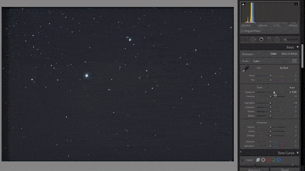

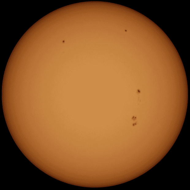

RAW files store a lot more information in the dark areas of the photo than JPG files... this is because JPGs are limited to 256 levels of brightness per color channel versus RAW files that often have 4096 levels of brightness per color channel or more. It's more of an art than a science, but the final look and feel of your images will be greatly influenced by the settings you choose in the software you use to convert from RAW to JPG. Essentially you're deciding which of the 4096 brightness levels to "throw out" when you convert to 256 brightness levels limit of a JPG. On the left below is a JPG straight from the camera and on the right below is a RAW file converted to JPG in Adobe Lightroom with custom conversion settings. Generally you will need different conversion settings for every different image to obtain optimal results, and that part of the process is more of an art than a science... You can see below there's a lot of information in the image on the right converted from a RAW file that isn't visible in the straight-from-camera JPG (the grass for example).
https://www.speakev.com/attachments/img-3033-gif.149501/
Devin-M said:
RAW files store a lot more information in the dark areas of the photo than JPG files... this is because JPGs are limited to 256 levels of brightness per color channel versus RAW files that often have 4096 levels of brightness per color channel or more. It's more of an art than a science, but the final look and feel of your images will be greatly influenced by these settings you choose in the software you use to convert from RAW to JPG. Essentially you're deciding which of the 4096 brightness levels to "throw out" when you convert to 256 brightness levels limit of a JPG. On the left below is a JPG straight from the camera and on the right below is a RAW file converted to JPG in Adobe Lightroom with custom conversion settings. Generally you will need different conversion settings for every different image to obtain optimal results, and that part of the process is more of an art than a science... You can see below there's a lot of information in the image on the right converted from a RAW file that isn't visible in the straight-from-camera JPG (the grass for example).
I see. Today I compared a JPG off my camera to a PNG that was made by processing RAW from the same camera through an editor and was mind-blown. I could bring out maybe 10x the details by just adjusting levels and curves.
I plan to take several RAW shots and stack them, and compare them to the stacked frames from MP4. That could be the missing link between the capture and eyepiece view.
Thanks.

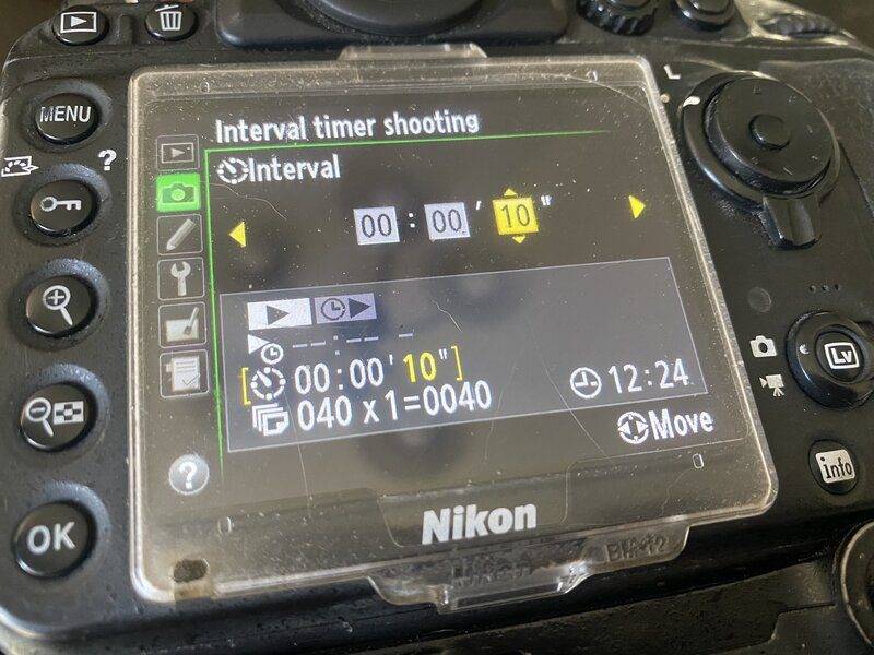

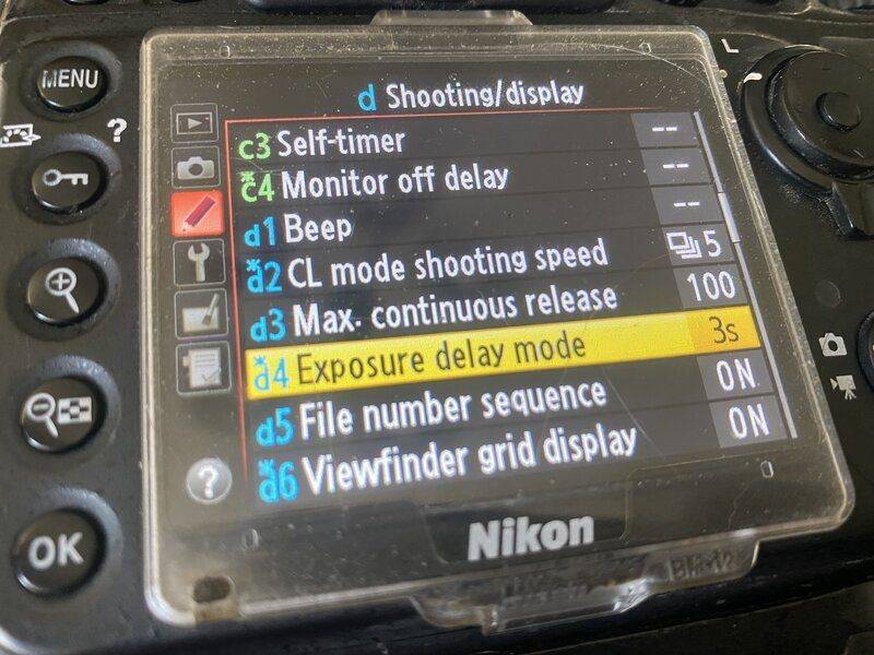

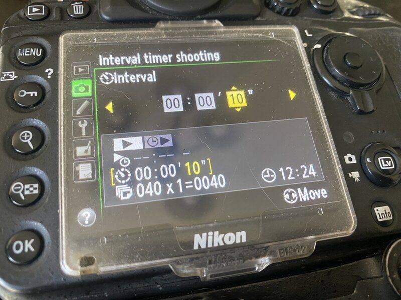

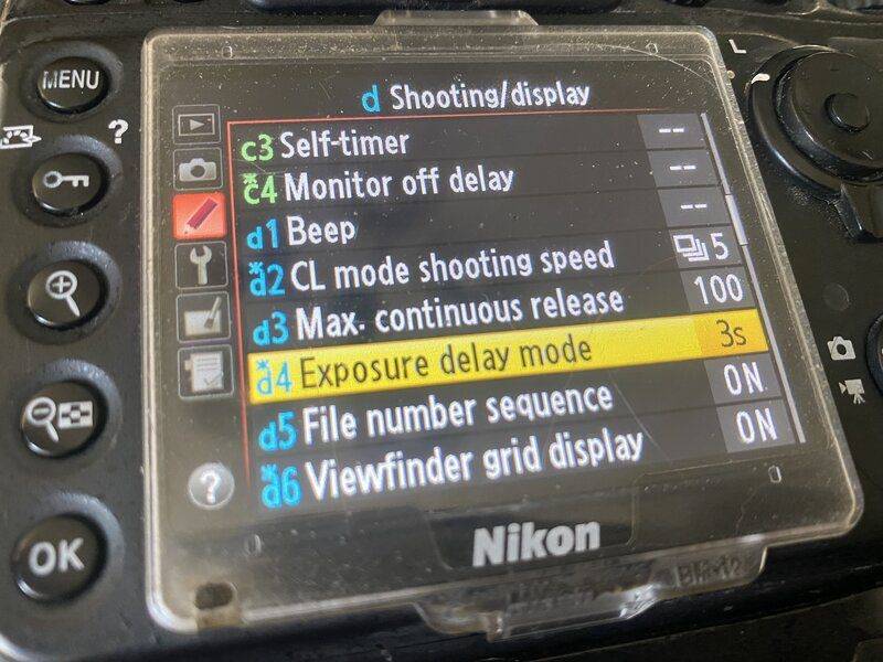

The mirror flip will vibrate your whole telescope causing motion blur on the image. What you can do is turn on exposure delay mode to 3 seconds which let's the mirror vibration subside for 3 seconds prior to shutter release. Then turn on interval timer shooting mode if you don’t have an external intervalometer so you can take multiple exposures without having to touch the camera which is another source of camera shake. I recommend getting external intervalometer so you can program longer than 30 second exposures like 2 minutes or 5 minutes in bulb mode but for that you’d also need an equatorial mount.
All the big boys use levels and curves (they may call it names like stretching and histogram but it's the same thing, basically.) JPEG is really not good if you want to reveal stuff that it has done its best to suppress, in the interest of data reduction. JPEG was invented for regular pictures which astrophotographs are definitely not.
I have an Intervalometer, I take exposures with that. And after checking, my camera doesn't have this exposure delay mode. What I do is I keep LiveView all the time so the mirror is always flipped up for the entire session. I saw that only the shutter operates for every exposure.
The only source of camera shake right now is when I frequently touch the focus knob. The scope keeps drifting out of focus due to the weight of the cam.
Lesson learnt. I will try stacking RAW captures next time and post processing to a lossless format.
Devin-M said:
That is a lot of mechanics there! Tuned spring-mass-damper system. Never realized that. I wonder if there is a way to disable the Mirror (thus viewfinder) action completely? I never use the viewfinder but being a beginner to photography and DSLR's I don't know if that sounds stupid.
I’d duct tape it once you have it in focus.
Some other good info:
"Some shutter mechanisms are linked to the mirror mechanism and requires a full cycle of both in order to recock the shutter. Since they are linked then the mirror must cycle down and back up even when shooting in live view so a subsequent shot can be taken.
Other models have a decoupled mirror mechanism that allows the shutter to fire and recock without moving the mirror. For example, Canon Rebels (XXXD and XXXXD) require a full cycle of the mirror during live view shooting while XXD and XD lines don't.
https://www.dpreview.com/forums/thread/3952158
Great! I removed the lens and watched what happened inside with the appropriate settings turned on and I am able to get only the shutter to fire without the whole mirror assembly banging around. It also feels 'softer' everytime it fires in LiveView. I think this part of the issue is fixed.

Devin-M said:
I made an animated GIF of histogram stretching a stacked 16bit tif of the Horsehead & Flame Nebulas in Adobe Lightroom (60x 2min 1600iso 600mm f/9 ff-dslr + 40 darks & flats, bortle 6):
